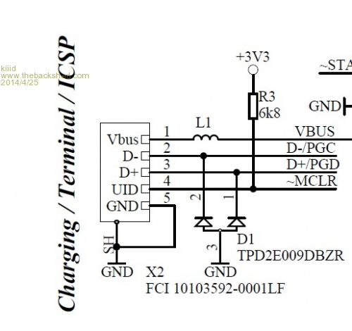

Posted: 11:48am 25 Apr 2014
A while ago I came up with this solution and used it in a few boards with PIC32 and PIC24, where (with a custom made programming cable) it gives me the option to program the device via the USB port and without a bootloader or extra programming header. Never seen it anywhere else, but it works just fine and could be of help to others.
Of course the resistor value can vary as in this particular case it is 6.8k purely for BOM optimisation.
http://rittle.org
