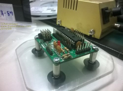

Mick,
What would be the correct way to program and power the Mup from a PicKit3 when VR3 is mounted?
If i connect the PicKit3 then both led's are on indicating that current is flowing from the 5v line through the red led. That means there is a current going through the Voltage regulator. I measured 3.2v on both 3.3v and 5v nets.
The 5v net gets enough current for at least the led.
I don't see another way to solve that then adding a jumper between the Voltage regulators Vout and the Vcc net.
In the block diagram of the MCP1702 there is a diode allowing current going from Vout to Vin. I did not measure a voltage drop.
If nothing else is connected to the Mup, i think it would not be a problem at all.
I programmed the chip without any problems.
Mentioning it in the manual to disconnect everything before connecting it to the PicKit3 would be sufficient.
BTW (also for Paceman (i tested it first to make sure they work) i used a 10uF Multilayer ceramic X5R 1210 smd chip capacitor and it works fine. They are about $0.20 and i have got a reel of those.
Here it is ready for action!
Edited by TZAdvantage 2014-05-09
Posts: 2984
Posted: 03:55pm 08 May 2014
Hi TZ,
It looks like your PCBs arrived by looking at your Picture.
I have been using the MPlab IPE which doesnt seem to have an option to power the target from the PICKIT so I supply power to the MuP and use the IPE to program the uMite.
Honestly all this IDE and IPE (well actually IDE) is a bit alien to me and I cant get the IDE to program under win 8.1, someone else here recommended the IPE and that works, and is easy enough to use, but as I mentioned use another source to power the MuP.
I did notice that once when I supplied a 3v3 supply to the MuP as the power source and I had VR2 installed that both LEDs lit... I wondered about that one but in my instructions I mention NOT to connect 3v3 as a power source when you have a VREG fitted..
I personally like the VREG and use a 5V source to supply the MuP.

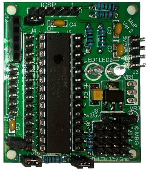

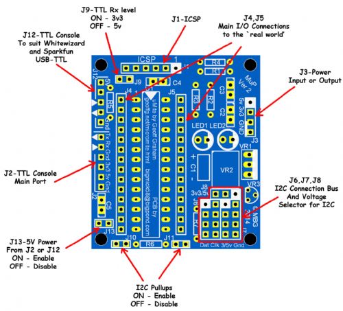

Posted: 08:24pm 18 May 2014
Gday All,
As Ver 1 of MuP had no pullups for I2C and had an error on the overlay for Dat/Clk pins, I have redesigned MuP and released a Ver 2.
MuP Ver 2 is identical in size to Ver 1 but is a much more useful board.
Here is a photo of MuP Ver 2:
Changes from Ver 1 include:
1.
Pullups for the I2C lines Dat & Clk with link options (J10,J11) to enable or disable them.
2.
The addition of a 1k resistor to enable 5V TTL level Tx(in) to be used, this can be jumpered out (J9) if 3v3 TTL Tx(in) is to be used.
3.
Fixed a silk screen overlay error that had the Clk and Dat labels for I2C reversed.
4.
Added a new header location (J12) to support WhiteWizard’s USB module.
5.
Added a Jumper (J13) to enable or disable 5V from the USB-TTL module inputs (J2 & J12). If MuP V2 is being supplied power through J3 AND a USB-TTL cable or adapter that has a 5V supply is connected, then J13 needs to be removed so that the two power sources will not `fight’ with each other. If 5V Power is required to be supplied via J2 or J12 then the jumper J13 will need to be installed.
Jumper Layout can be seen here.
I have asked TassyJim, if he is still willing, to kindly offer to host the new Manual for MuP Ver2 on his site. When it is available either he or I will post a link here. In the meantime if anyone desires a copy of the manual PM me with an email address and I will send it to you (1.3MB in size, so TBS forum wont let me post it directly here -- 500kB max allowed.)
