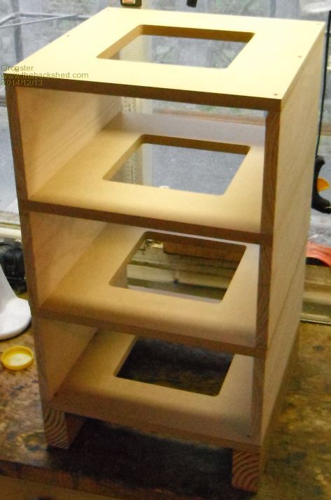

Posts: 10070
Posted: 06:35pm 04 Oct 2014
An update for this thread.
I have 50 or so photo-interrupter PCB's all ready to go for the shaft sensors.
Today I built the "Core" of the "Building".
The building will be 6 floors with ground and basement, so 8 levels in total.
Unlike a "Proper" core, my building won't have anything other then the shaft guide-rails, so you can see what is going on when things start moving etc. At real-life structural level, the guide-rails will support the fake core of the building, and I will add MDF strip corners to the building which run right up the side, to hold the outside edges together.
I am using those rails you buy for adjustable shelving, turned around the other way to act as guide rails for the cabin and counterweight. The cabin has four guide rails, and the counterweight has two. The rails are 1500mm long each, with holes for screws every 200mm, so my "Floor spacing" is 200mm centres, just cos it is nice and easy to adopt what is already factory punched for you.
I have cut the eight floor slabs from 18mm MDF, using a local joiner business to cut the 200mm centre holes which will become the actual shaft. I got the joiner to do this, cos they are neater then my hand and a jigsaw, and to prevent warping the guide-rails and causing things to stick, the shaft holes in the floor slabs need to be as accurate as possible - much difference between floors would bend the guide-rails, and cause the cabin to stick rather then ride up and down nicely.
We're into daylight saving now, so I hope to be able to spend an hour or so on construction after work from now on.
I will post photos in the next day or so.
Posts: 10070
Posted: 09:59pm 12 Dec 2014
I forgot to post the photo ages ago:
This shows the first four floors out of eight in total, so this is the building under construction at 50% of it's final design height, but you can easily see the elevator "Shaft" and how the floors will look.
I changed the design a little and decided to put left and right walls in for structural reasons. I was just going to put little corner bits in, but it was easier and involved less cutting to just make "Walls".
The front and back will remain completely open, so you can see the cabin and counter-weight riding up and down on the guide-rails. I plan to put the remaining floors on it tomorrow so that I can then paint it to protect the wood. Once I have done that, I will set about installing the guide-rails, cabin, counter-weight, cables, sheave and motor.
Still plenty to do, but it should be a somewhat unique project among my others!

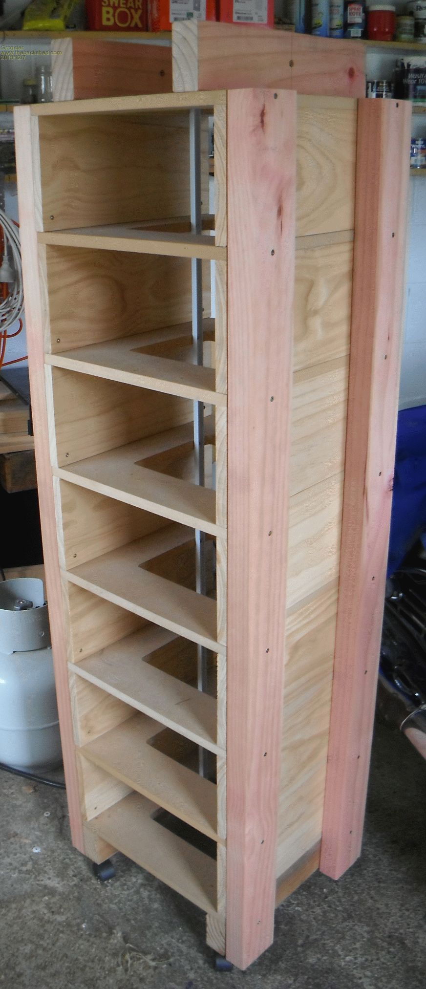

Posts: 10070
Posted: 01:36pm 11 Feb 2017
UPDATE: I have not abandoned this project, but there never seems to be any time to play with it at the moment! Having said that, I did play with a concept on the sensor input, which will DRASTICALLY cut back on all the I/O pins needed for the sensors.
Conceptually, I plan to use a multi-turn pot similar to these which can be had very cheaply on eBay these days.
Number of floors divided by 10 to work out how much of a turn you need on the multi-turn pot per 'Floor' - this involves custom making a wooden pully for the pot, that will turn the pot the correct amount depending on the number of floors you need to cover. The easiest way to do this is probably TWO wooden pullys, with one on the pot at the top of the shaft, and the other one in the basement at the bottom of the shaft, linked with a loop of 'Rope'. The rope is secured to the cabin itself, so that when it moves, this will result in the rope moving both pullys, and therefore, the position of the pot. All that would be quite easy to build, as it is simple and only needs two suitably sized wooden pullys to be made.
The idea being that at basement level, the pot will read zero, and at the top floor, the pot will read 10k. With that in mind, you can then use the pot and ONE single analog input pin, to read the pot, and thus the one pot will do ALL the shaft sensor work. Just by reading the analog input pin, the MM will know exactly where in the shaft the cabin is, and once you manually set the floor-level readings from the pot(only needs to be done once), the MM will then have reference points for all the floors, so will know exactly when to stop the cabin, and it will be level with the floor.
What this means, is that the entire project could probably be controlled with ONE 170 MM2 chip - and still have enough pins to have an SPI touch-screen for control.
In reality, I plan to use a 44-pin MM2 chip.
This is a low-priority project, however, the saga for this one continues.....
