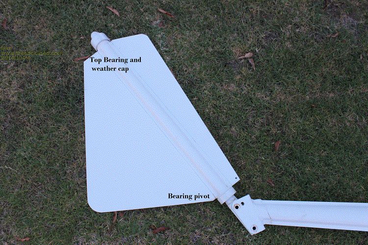

phillm, briggsy,
Can you describe briefly how the furling on this works on this design. Does the rotation of the vane just push the machine out of the wind, or is it actuating something more - blade pitch maybe?
I was assuming it is the former, but it is a bit hard to tell from the video. And, there is no offset IIRC?
~ks
fillm
Joined: 10/02/2007
Posts: 730
Posted: 01:25pm 23 Oct 2014
KS, Briggsy,
There is approx 120mm of blade off-set so it works on the same principal as a full tail furling. The tail fin is made from approx 1.6mm pressed sheet steel and pivots on an angled shaft, sealed bearings. So with the shaft being angled straight back at 20deg or 15deg ( angles example only ). Because the tail fin has a heavy the weighted side it will always hang in that position trying to keep the turbine into the wind.
When the off-set force pushes the tail around against the wind, then the tail fin will pivot to the direction of the wind if the blade off-set force is greater.
I actually now am quite a convert for this type of tail furling as it will always allow for cushioning from extreem side gusts and allow for the blades gyroscopic inertia in high wind. After watching a 3.8m set of blades hit the tower and destroy themselves because the tail was hard against a stop and blades spinning at high RPM, then with a strong side gust pushed the tail on the stop violently this was enough to cause flex in the blades and strike the tower.
I have one 2kW down preparing it for the customer, here is a pic of the tail.
I also have noticed from pictures on early Jacobs mills the tail is centered between 2 springs that give some cushioning for this type of wind force.
Briggsy great video, if you ever get sick of seeing the turbine constantly hunting for wind and doing 360 degree turns in light to medium wind when it should be making power I can give you the solution that will give you 2x(in strong wind) to 100 times more power output (in light to med wind). The wind must have been gale force 15+ m/s to be getting 2kW from a standard set of blades at 3.2m dia. I have not logged over 2kW on the standard turbine in wind up to 60Klm where the OZ Wind modified is easily hitting 2.4kW at 40klm ~ 50klm 10 ~ 12m/s.
Good to see you have a nice set up with the grid feed ... Well Done Edited by fillm 2014-10-25

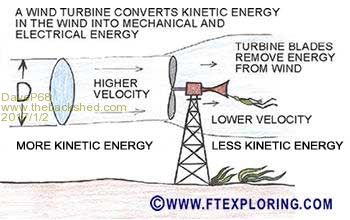

Hi Phill
I came across this old post of yours while doing a search on "GOE222 blades". Was curious about their performance, as I had already ordered some from you last month and was looking froward to receiving my own set soon.
Was watching your YouTube video titled "2kw Turbine Full Movie"
While watching the video at 3:40 I would like ask how you are able to extract around 1000 - 1200 W of power o/p in around 22 to 23 kph of wind with 3.2 m diameter GOE222 blades?
I'm not disputing that you are getting 2.3 kW in 40~50 kph of wind that you have sited on the first page of this post.
Using The Back Shed formula of Wind Power = Air Density / 2 * Area * Velocity³.
This is what I get 1.225 / 2 x 3.14159 x 1.6² x 12³ = 8512 W then take off Turbine Efficiency say 35% along with Alternator ( or Generator ) Efficiency of say 80% I get 2.383 kW of power. So from 12 m/s (43.2 kph) wind speed with 3.2 m diameter blades 2.383 kW of power, so no problem so far..
Now lets try 6.5 m/s (23.4 kph) with the same calculation of 1.225 / 2 * 3.14159 * 1.6² x 6.5³ x 35% x 80% = 379 W that is well short of 1000 - 1200 W!
As per what is on this website, how does wind speed affect the power? A great deal! If we almost halve our wind speed from 43.2 kph to say 23.4 kph is 6.3 times less power in the wind.
I'll try again with 7.95 m/s (28.6 kph) which you have a screen shot of your wind turbine making 1704 W. With the same calculation 1.225 / 2 * 3.14159 * 1.6² x 7.95³ x 35% x 80% = 693 W that again is well short of 1704 W.
There is just something not right about the numbers that your data logging equipment is displaying.
I did notice in the YouTube video that your wind speed Anemometers are mounted on the mast very close to the bottom the blades (just below). You will get an air pressure drop behind the blades as the Anemometers will always be in that low pressure region regardless of wind direction. Refer to the following picture.
I also hope you are using the exact the same PMA on the other blades that you are making a comparison with, as if it is different that resulting output differences will be meaningless.
Anyway Happy New Year to you.
