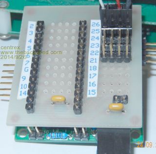

I personally would prefer small plug in modules for connecting to the MicroMite and to this end I made myself a board the same size as BigMicks MuP that allows me to connect what I want.
This board plugs directly into the MuP and gets as well as all the i/o pins the 5volt supply from the I2C section of the MuP.
I have not fitted all the pins to the i/o as yet but the MuP is running the RTC, 4X20LCD, BMP085 and a DS18B20.
Hopefully in the very near future a FRAM memory module.

@ centrex - can you please post a link for that module you put up the photo for?

Posted: 04:11pm 27 Sep 2014
Hi Grogster
Google ADAFRUIT FRAM it will be in the first couple of items.
https://learn.adafruit.com/adafruit-i2c-fram-breakout/overvi ew
