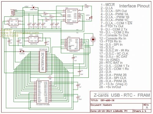

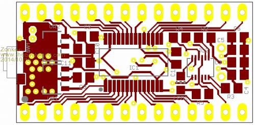

Posted: 08:36am 18 Oct 2014
Good afternoon Gents...
Well, after a few days delay, I think we got this one to the done state...
A bit more cleanup work that expected...
Will post the Gerbers after final checks...

Hey Zonker, What are the final x,y dimensions (in mm) of the module?
Zonker
Joined: 18/08/2012
Posts: 772
Posted: 10:46am 18 Oct 2014
Hey Phil...
I got: Inch 1.4125 x 0.7218 y , mm 35.8775 x 18.4150 y
It should fit on the small I-tead board size...

Well, since the gerbers are untested, I figure on ordering 20 boards from I-tead and try hand building 10 of them up to see if they work ok... Lou and I will give a go at the soldering iron and see what happens... Assuming that goes ok, we should have a set of completed units and a set of flats to pass around for others to evaluate...
Attached are the Gerber files in I-tead and Eagle format names...
2014-10-18_222316_DIP-600-28_Itead_Gerbers.zip
2014-10-18_222345_DIP-600-28_Standard_Gerbers.zip
I looked these file over using this Online Gerber Viewer to check the output... they seem ok to me but have a look to see if I missed anything...

I have ordered 20 boards from Itead and sent them the Gerbers... They have already responded back saying that the files have checked out OK and are producing the boards... (wow, that was fast) Should be ready to ship within a week... (sweet)...

Finally got a BOM worked up on the DIP-600-28 Board.. I am still waiting for the boards to arrive, but The parts I orderd, USB socket, reset Sw, FTDI chip, and RTC-Fram chip (25 of each) arrived today. ($432) Lou bought the rest of the parts. I am not sure of his cost yet... Between us we basically have spent $600 (not including shipping) for this prototype run..

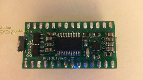

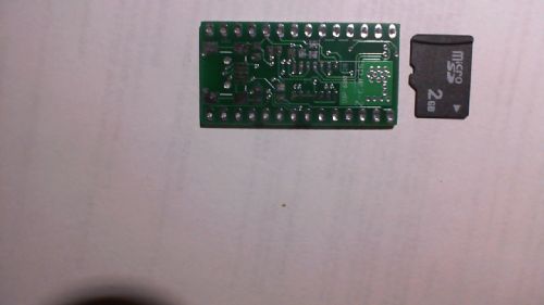

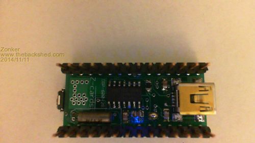

Zonker
Joined: 18/08/2012
Posts: 772
Posted: 05:38pm 10 Nov 2014
Good evening Gents...
OK.. Just got the first one built, programed and working..! (sweet)
And the back side view...
Next is to get the RTC and Fram IC talking...
