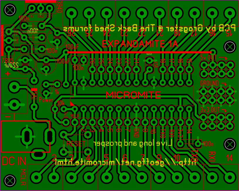

  Grogster said   How about this Rob? (and OP, naturally!)
Single-sided, all through-hole parts except for the 3v3 regulator, which is SOT-223, and big enough for it not to be any problem to solder.
PCB terminal block connections on outer edges, pin-headers close to chip, ISCP, on-board regulator and DC output bus-bars. The only thing I could not squeeze in, was the DC socket, but this is the first attempt...

A few comments..
The 220uf and 100uF cap are a bit too close to the Regulator.
I would try to put a Bypass cap near Pin 13..
The diode on the right hand side (19) even if LDO would drop 0.3-0.4V so your 3v3 headers would be 2.9v-3.0v
I would increase the size of + and - on the input to it was more obvious.. Maybe change to Gnd and Vin or similar
Good effort in such a short time frame.

Good effort there Grog's and I love sprint layout for designing pcb's as the gerbers convert nicely for cnc milling. Now it does appear the umite and the rest of the components are soldered ontop of the board and not thru hole. I could be wrong but the orientation of the umite gives me that impression.

Grogs, If Bryans assumption is right the the screw terminal connectors would have to be on the non copper side.

Bryan, most PCB programs will show you a view from the top looking through the layers. In this case the parts would be on the top, the single layer copper on the bottom.
Personally i like to regulate the voltage first to 5v and then to 3.3v.
They will get less hot and you have a 5v available, very handy for some external sensors/parts that need it.
The ICSP connector might be just a little to close to the mcu. You might not be able to plug in a pickit directly.
Maybe an extra USB connection to supply power only. It might fit over the footprint of the DC connector giving the user a choice which one to mount.
Are those caps not overkill? 10uF seems to work just fine.

  TZAdvantage said   In this case the parts would be on the top, the single layer copper on the bottom.
Yes, I agree the picture is a view from the top looking at the Bottom layer.
In this case the Regulator is bottom mounted and as such the 220uf and 100uf caps I mentioned do NOT foul with it... My Bad...
Posts: 10103
Posted: 12:23pm 10 Nov 2014
Just to clarify for everyone - yes, the picture is looking "Through" the PCB, from top to bottom. Only ONE copper layer, and that is the bottom one. No top copper. All parts mount through-hole from the top. Just like any other SS PCB, in other words.
@ Mick: I was going to mention about the SMD regulator, but you picked up on that. I wanted to put a 100n by pin 13, but could not squeeze it in. If I put SMD caps there, not a problem. Diodes marked 19 are 1N5819 Schottky diodes with 0.1v voltage drop, so at worst, the 3v3 would be 3v2. On the input it is not a problem, as it is only being used as reverse polarity protection. On the 3v3 bus output, technically yes - you would lose 0.1v making the true output 3.2v, but I still think that is close enough. Thoughts?
QUESTION - IS ATMEGA8 ET AL HAPPY WITH SOME SMD, OR DO YOU NEED IT TO BE ALL THRU-HOLE? SMD allows more the be squeezed in, naturally, but many are frightened of it...
@ TZA: Manual for 1117 says on page 1, that minimum of 10uF tantalum on output, so 100uF electro is what I used. Now, I know that is a SMD regulator, but I am about to change that to a 1117 at Rob's suggestion - I think. Now that you mention 5v as well as a pre-regulator, I am thinking of keeping the SOT223 idea, as I can squeeze the extra regulator in there, and have 5v and 3v3 available - this is a good idea.
@ Bryan1: Yes, Sprint Layout 6 is what I used for this.
@ atmega8 - I used Sprint Layout 6 for this PCB. Rob's Kick-Starter idea notwithstanding, the plan was to release the files as gerbers so anyone could make it. It's just a cheap-as-chips, simple-as single-sided PCB layout. To me, it is not really worth marketing, but then - what do I know!
EDIT: On the regulators, I can put a 7805 on the left side of the board, and a 3940 on the top-edge of the board, which would allow for external heatsinks if needed. That is the plan there for the moment. At lease the 3940 uses the more standard input-common-output pinout!!! Edited by Grogster 2014-11-11

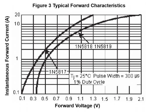

I wouldn't put a lot of faith in only a 0.1v drop across the 1N5819.. In my playing with them I find it closer to 0.3V TO 0.4v..
The specs are a bit vague on static current draw but the table of a 1% duty cycle shows exactly my results for the IN5818/19 but the 1N5817 (which I have never used) is at 0.1V at 100ma but these ramp up as current increases.. at 40V 1A draw the 1N5819 drops 0.87V but of course you aren't using them at that current/voltage either.

@ Mick - We could drop the 5819 on the 3v3 output totally - that would get around the problem, so long as there was a clear label on the 3v3 bus side of things that this was an output only, and not an input. That's the only reason for the diode - to stop someone connecting power in to that point, which would be OK for the Micromite, but it would mean feeding 3v3 into the OUTPUT of the regulator, which I thought would not be a good idea.......

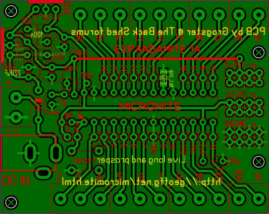

UPDATE: Have played with the layout, and now have DC socket on-board, and 5v regulator. I have had to go to SMD for some parts, but they are 1206 which is not too tricky to solder. If anyone is interested in this board, I could supply the boards with the SMD already soldered, leaving you only to assemble the rest of the through-hole parts. I have a ton of all the 1206 parts, which is one reason for designing them in. The other is lack of space.
I have done away with the ICSP header at the suggestion of Rob. This was a good suggestion, as you have access to the programming pins on the t-blocks or headers anyway. Yes, you will have to wire up for programming, or just program the chip elsewhere and do a chip swap - either is easy, really.
On the right of the board, there are now eight connection points via the headers, for 3v3, 5v and ground. These could be header sockets instead of pins, allowing you to plug in breadboard jumper wires etc.
EDIT: Have got rid of all but one SMD part, which is a zero-ohm link. All standard thru-hole parts now, except for that one link. I am looking at ways to replace that.
EDIT: Done. Replaced with wire-link top-side. I know that the aim is for no links at all, but.... PCB is now single-sided, and NO surface-mount stuff. All parts are thru-hole.
EDIT: Whoops! Forgot Vcap. Will change that.Edited by Grogster 2014-11-12

The mclr is missing on the t-blocks and I would not move pin one header 0.1" to the left.
The power connections on the right are easier to use when the grounds are in the center. That will prevent the wires connected to them being entangled. Maybe do rows of power and ground to keep the wires close together and in the same orientation.
Like:
[code]
5 5 5 5
G G G G
3 3 3 3
G G G G
[/code]
Only one wire jumper is a great accomplishment.😃

OK, how about this then:
