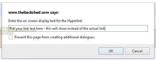

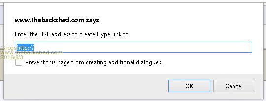

When you are writing your reply in the reply box, click this button:
A box will pop-up:
Press ENTER when you have typed what you want the link to say.
Another box will pop-up - paste your actual link into that box, and press ENTER.
That will paste in the HTML code needed to show the link, and make it clickable for everyone.Edited by Grogster 2016-08-04

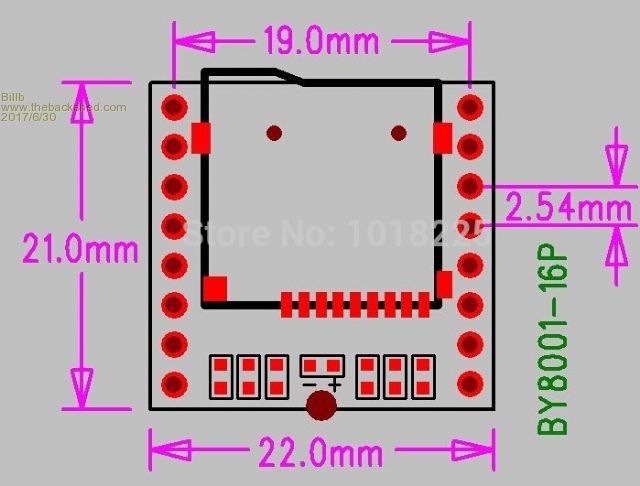

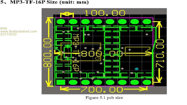

Bill - Could you please confirm for me that the spacing between the two rows of pins on this module, is 17.7mm or so? I have ordered some of these modules, but I would like to design a PCB footprint for it while I wait for them to arrive....

...those units are not mm...
This diagram is saying the module is 800mm square and 710mm between the pins with a 100mm pin-pitch - that simply can't be right.

The manual shows the incorrect sizes.
This one appears to be right.
Bill
