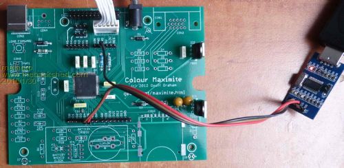

I've got to the point where I think it is about safe (i.e it should probably end up working!) to reveal what I have been up to

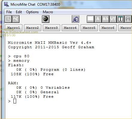

With Geoff's help and agreement I've been porting the Micromite firmware to the PIC32MX470F512 chips - why?
Twice the flash memory and RAM - see the picture
Twice the speed, Currently the maximum is 80Mhz but 96 should be possible if I can sort out some sort of configuration issue.
A full 16-bit data port completely separate from all of the special purpose pins - perfect for driving TFT displays even faster!
The PIC32MX470F512 is available in 2 packages that are useful to us, a 64-pin TQFP and a 100-pin TQFP, the same firmware will support both but it is different from the 28 and 44-pin versions. The 64-pin chip is probably the perfect version for us.
I've mounted the 100-pin version on a spare Colour Maximite PCB as a test-bed. A mono-Maximite PCB or mini-Maximite would be an ideal test-bed for the 64-pin chip. If anyone has a spare of these lying around (or anything else suitable) they would be willing to let me have please PM me.
The pinouts of the 470 chips are exactly the same as the PIC32MX695 chips used in the Maximites but for the avoidance of doubt the 695 chips are much less similar to the 170s and I will not be porting to them!
Once I've done more testing myself I will be asking for volunteers to beta-test the code and if all goes well I'm hoping Geoff will take it over as part of the official Micromite release - hopefully he won't find my code too terrible.

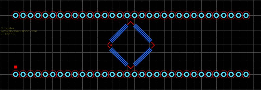

Obviously, the relevance of this to this thread is that the 64-pin version would make the perfect CPU for a display backpack.
The starting point though should probably be a DIL breakout like the ones that have been made for the 44-pin chip.
I've attached the pin-out details for the chips ( equivalent to pages 6 and 7 in the Micromite manual) for information.
The current status is that the chip is up and running as evidenced above. I can load and run programs (including Cfunctions) through MMEDIT and use local edit as normal. The increased CPU speed is definitely effective (6msec for my sort code vs 11 before). I can address all the I/O pins but I haven't yet tested any functionally.

Posts: 2981
Posted: 12:02am 30 Jan 2015
Peter,
PM me your address and I will send a Mono maximite PCB to you.
PS.
Sounds mouth watering
EDIT***
Damn.!!
Only yesterday I placed an order for some more blank 170's (I even bought some 44 pinners) If I had known I would have bought a few 64pinners to try..
MickEdited by bigmik 2015-01-31

Posts: 11910
Posted: 12:35am 30 Jan 2015
  Quote  Are you using the PMP for driving the display.
Give me a chance
I'm still trying to get the chip working fully - there were a lot of configuration changes needed!
However, it is not my intention to implement any additional functionality into Basic - that is Geoff's prerogative.
My pinout leaves PortB0-15 completely free and it is possible to assign these pins to the PMP although the 64-pin devices only allow 8-bit PMP databus usage.
Driving a 16-bit parallel TFT just using portB from a Cfunction should, allowing for the faster clock speed, run about 4x faster on this chip and it was already pretty quick. The PMP would certainly give additional gains but requires a lot of set up.

Posts: 10048
Posted: 02:50am 30 Jan 2015
PIC32MX 64-pin chip can be had here.
820 in stock, US$6.46 each.
EDIT: Preliminary DIL breakout PCB - no tracks yet. This is a standard 2.54mm grid, with 20.32mm pin spacing.
Edited by Grogster 2015-01-31
