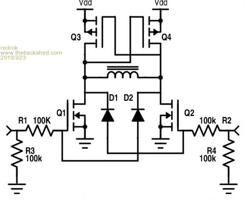

I know your circuitry is already designed but I would be remiss if I didn't show a very nice all MOSFET H-Bridge:
The high side DMP2215L-7 MOSFET would work well at 3.3V.
The 2 diodes guarantee minimal shoot through in case both MOSFETs are enabled at the same time.
When running it at higher voltages make sure the high side MOSFET maximum gate voltage is not exceeded.
redrok
Posts: 10054
Posted: 12:50pm 23 Mar 2015
Cool.
Printed for future reference.
