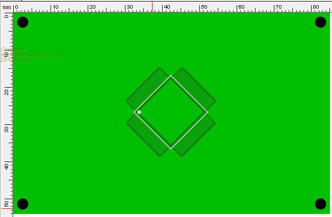

@ matherp - it's all fine. I was only worried that I may have been promoting my own ideas as some kind of "Way it should be done" - not intentional. Having re-read my posts above, it could be interpreted that way to some extent, so for that, I am sorry. I will proof-read my posts a bit more before I hit the POST REPLY button!
@ Rob - Interesting challenge, but what about matherp's comments on the hardware side of things? Sounds like he has already checked that idea out as fart as the 695/795 chips are concerned. Perhaps one of THOSE(a 470 100-pin) in the middle of your credit-card sized PCB? Assuming $20, does that include PCB cost, or is that $20 just a component budget?
EDIT: It begins!!!!!!!
Conceptual drawing only, but I love a challenge, and you, Rob, have posted a worthy one! Edited by Grogster 2015-02-17

going with the MX470 returns about us$5 back into the budget. yes, the us$20 budget needs to cover everything, including the PCB and cost of stuffing the SMD parts onto it. non-SMD parts can be soldered by the hobbyist to cut production costs.
@geoff: given that the 32MZ is now out of contention, would the MX470 form a good core for a colour maximite III?
rob :-)
Posts: 10062
Posted: 12:46am 16 Feb 2015
Hmmmmmmm - not sure that is possible. Including the PCB, maybe, but the PCB and all the SMD parts fitted, all inside twenty bucks - challenging! The problem is mass-production. Many PCB houses will assemble SMD parts onto your boards for you for a fee, but you need to get at least 50 boards I think - it may even be 100 boards. You do get very good rates vs assembling them yourself though. The other option is to finish my flippin' reflow oven, then you could bake at least four boards at a time, and a correctly setup reflow oven will do four boards every 15 mins or so. Food for thought. Time for bed.

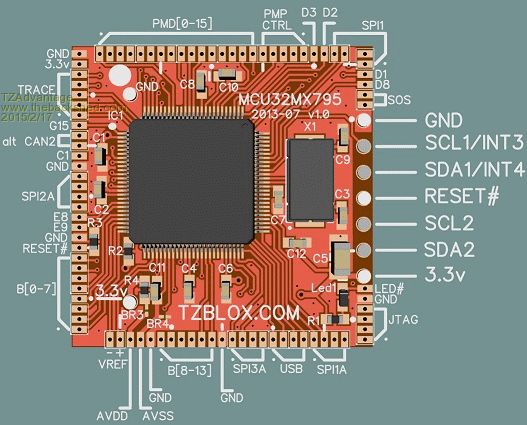

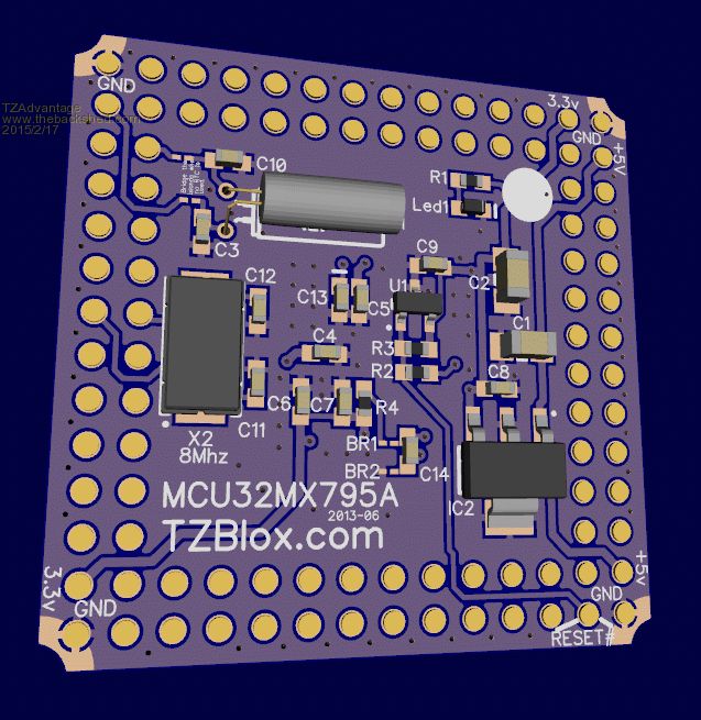

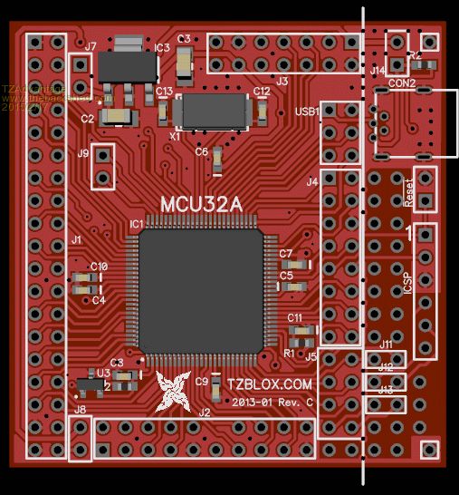

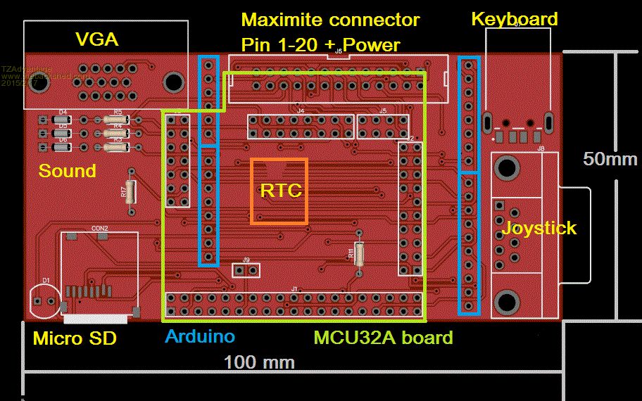

I already designed something like that 2 years ago.
The idea was to have the mpu on a separate plugin module so you would have just a processing module with all the stuff that is needed like caps and crystal.
Then all the connectors to make it into something specific, like a color maximite by using another board.
Like this:
That would be all through hole to make it easy for a hobbyist.
The mpu module would be all smd.
That 'module' evolved to:
and this:
Until a in my eyes a disastrous kickstarter (Color Maximite) changed my view together with the arrival of the uMite. Then the 150 was actually more interesting,until it changed into a MkII with the 170 and now again changing into a 470.
It is all getting better and better, but to build some parts that are a little bit more viable over the long term is the only way.
So wait some time to sit out this 'storm' of new things then settle for a model, then produce some quantities to get an interesting price.
Posts: 10062
Posted: 09:32pm 16 Feb 2015
They look like excellent boards, TZA. Perhaps my work is done....
@ Rob and anyone else following my board: Have not added anything else to the board as yet, as it was just me playing about with the board size, so not sure it will go any further at this stage. It COULD form the basis of a big-brother to the SkinnyMite board though, I guess....
There is no harm in playing about, even if it proves to be impossible - it's all exercise for the little grey cells.

tzadvantage: the problem with the MCU32A core board et al is that the design philosophy looks to blow out the us$20 budget. what do you reckon the production cost of a set of your boards would be? the MCU32MX795 looks like it may be a commercial product that you sell - what is the retail price?
