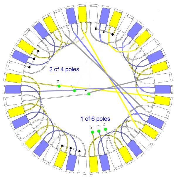

Posted: 09:38pm 10 Oct 2007
Glen
This question was asked and I have waited for a reply since.
  Gill said   Glenn,

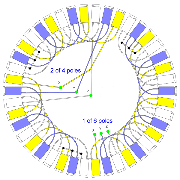

How are you going to space the arrangements on both stators? I can't see any balanced arrangement there, but maybe you have a trick up your sleeve? [end Quote]
Is it possible for you to do a quick colour diagram of the two stators and how the 6, 5, 4, 4, 3, 3, 3, fit in a balaced fashon.
If you could use pictures like you produced in this case,
http://www.thebackshed.com/Windmill/FPRewire.asp
That would be very helpfull.
I am very interested in copiing your great ideas again.
Brett
Posts: 5193
Posted: 08:50am 11 Oct 2007

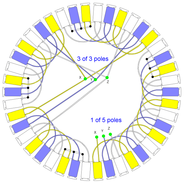

Hi Brett
Ok, here are the drawings. This is exactly how I re-configureed the stators, ends up with 4 new 3 phase circuits, each with a different start voltage and current capability.
Hope that gets you started. You could use just one of these on a single stator windmill, top one would be better. The 5 pole would give power in light winds, then the 3 poles once the wind gets going.
vasi
Joined: 23/03/2007
Location: Romania
Posts: 1697
Posted: 09:25am 11 Oct 2007
Thank you Glenn, the top one I will use for the 80 series. Maybe with your blades. I think together is a complete solution for low winds, and deserve a separate page on your site.
I think, the second one is good for 100 series?Edited by vasi 2007-10-12

Here is an even spaced stator for the 6 + 4 x 2
Sorry the graphics are not up to Glenn's quality.
Cheers Gill _Cairns, FNQ
