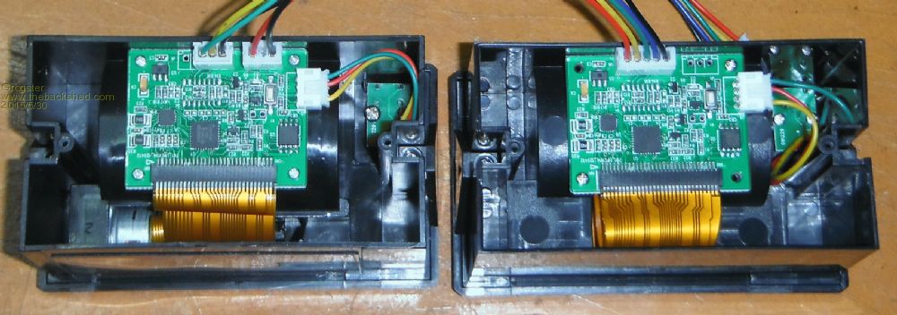

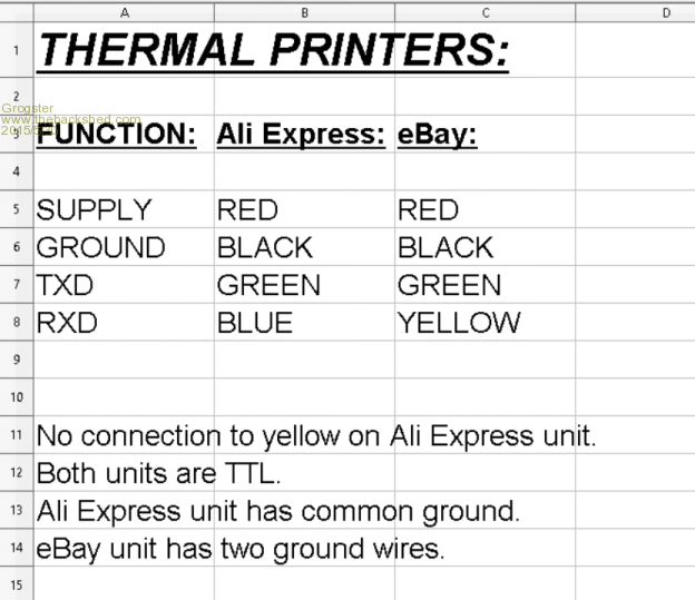

Posted: 12:40am 30 May 2015
UPDATE: I have worked out how to change the code-page reference, so that I have replaced the Chinese characters with the more standard(for me!) code page 437, or CP437 MS-DOS font.
The printer from AliExpress is exactly the same printer, and cheaper then the eBay ones, but the wiring is slightly different. However, the printers are electronically identical:
Changing the code page requires use of the software tool. By default, these printers come with the "Traditional Chinese" code page programmed into them, but once you have the tool, it is simple to select the code page you want to use. There is an Engrish document in the ZIP below showing how to do this, but you just run the exe programming tool, and follow your nose, really.
Using this tool, you can also reset the serial baud-rate, but I left mine at 19k2 - seems to work well at that speed.
Thermal Printer setup and documents ZIP file (9.7MB)
EDIT: The printers from AliExpress do not print anywhere near as black as the eBay ones. Looking at the images of the printers with the backs off, you can see the circuit is exactly the same, but their are differences in the ribbon cable going off to the print head between the two. eBay unit is on left, AliExpress unit on right.
My testing was with the same exact roll of paper, which was the good quality paper. BOTH the AliExpress printers have faint printout, although they work fine. This may be something that can be tweaked, as there are commands for setting the dot heating time, so extending this just a fraction may well then render the same results as the eBay units. I have two of each, and both eBay ones give great results, whereas both the AliExpress ones are faint in the printout. The AliExpress ones were much cheaper - about half the price of the eBay ones, so I suspect the AliExpress ones use a cheaper print head.
I will have a play with adjusting the heat time on the AliExpress ones tomorrow to see if I can improve their printout.Edited by Grogster 2015-05-31
