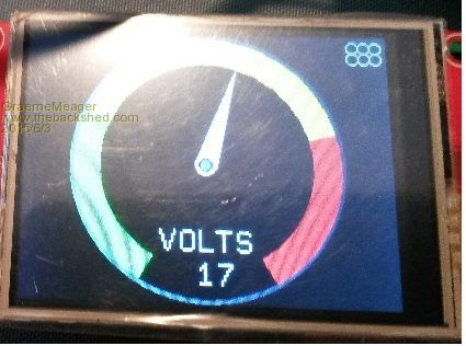

Thought I would combine Peters great work and use the 6 gauge screen as the main screen and when one gauge is tapped the LCD shows only that gauge for closer inspection with an icon on the top right to return to the 6 gauge screen.
GM

I was looking at this thread last night and I was thinking that the next evolution of this should be exactly what you have done today. Excellent work. Now all you need is Mick's suggestion of flashing the background red when a gauge goes into the red.
Bob

  Quote  Now all you need is Mick's suggestion of flashing the background red when a gauge goes into the red.
I will look into it, even giving the icon coloured in circles representing the state of the 6 gauges.

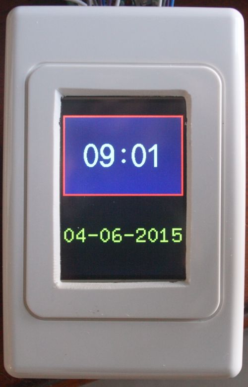

All I need now is a decent way of mounting them.
The BOSS has conceded to having one on the wall for a weather station display.
My effort so far with a 2.4" display:
It is a 'Delta' brand light switch/blanking plate (from Bunnings) with the innards cut out.
I made the hole a bit too big but it allows fat fingers to 'touch'.
The standard mounting holes had to go but there are plenty of other mounting holes to use.
It might look a bit strange on the dash of a plane/boat/car but the BOSS is happy so I am happy.

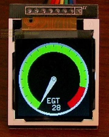

Posts: 11959
Posted: 12:59am 04 Jun 2015
Here is an additional feature, the ability to put small scale marks on the display
Call for the above was:
initgauge(0,mm.hres\2,mm.vres\2,mm.hres\2-5,1,-150,-150,105,105,150,"EGT",15)
where the final 15 is optional but specifies putting marks at 15 degree intervals. The revised routines are given below.
Also attached as a zip file is a fully implemented EGT program ready to go into the aircraft
2015-06-04_111036_egt.zip

' Routine to initialise a gauge
' Parameters are:
' gaugeindex
' x-coordinate of centre of gauge
' y-coordinate of centre of gauge
' radius of gauge
' font size
' start radial of white segment (-180 to 180)
' start radial of green segment (-180 to 180, must be greater or equal to start of previous segment)
' start radial of yellow segment (-180 to 180, must be greater or equal to start of previous segment)
' start radial of red segment (-180 to 180, must be greater or equal to start of previous segment)
' start radial of black segment (-180 to 180, must be greater or equal to start of previous segment)
' string to display as gauge title
' spacing in degrees for any scale markers, set to zero or omit if not required
sub initgauge(gaugeindex% , xpos%, ypos%, gsize%, fontmult%, whitestart%, greenstart%, yellowstart%, redstart%, blackstart%, displaystring$, tickspace%)
