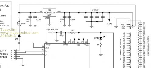

Hi TassyJim,
can you please paint a lite schematic for this workaround?
It is difficult for a not native english speaker to understand this...
THX

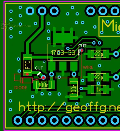

  TassyJim said
I have my explore64 wired as per the V3 circuit. Diode isolating the USB power and the Vbus routed to the USB side of the diode.
Posts: 6621
Posted: 12:57pm 13 Aug 2015
  atmega8 said   Hi TassyJim,
THX
I also added a diode in my external 5V to stop the USB from trying to supply the external circuit.

Posted: 01:08pm 13 Aug 2015
ahh, ok i understand...but where do you feed in the external power?
Will try this...
But very is the (causal) problem located?
Does Geoff have to fix the usb implementation in mm+ or ist there an incompatibility in the MS WIN 10 USB Implementation ? Edited by atmega8 2015-08-14

@TassyJim:
That's exact the same solution that I am found!
...but I will use a SMD diode as triangle with the PTC - than it is not necessary to cut the track below the PTC.
@atmega8:
You can feed in the external power on the "5v0_OUT" Pin. The voltage is blocked by the diode and goes directly to the regulator...
Frank

Just a quick comment on the Silicon Chip Driver, Win 10 and the MM+.
I had a similar effect with Win7 when I was developing the MM+. At the time I thought that it was a USB hub issue because when I switched to a different hub the problem went away. The symptom was that the USB enumerated correctly only when the Explore64 board was powered from an external 5V supply.
Now my suspicion is that it is an issue with the USB driver on the MX470 and could be related to the CPU speed. It will be at least three weeks before I can look at it but it will be high on the list of priorities.
GeoffEdited by Geoffg 2015-08-15
