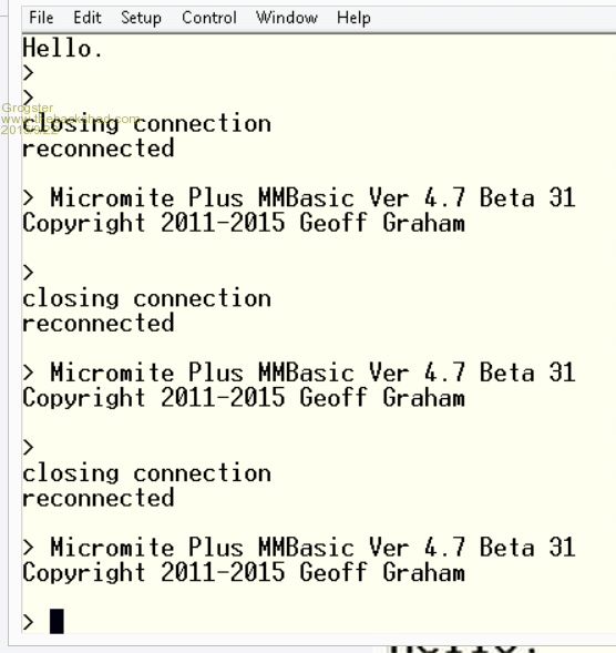

I am getting the same result as you now, CFLY:
From the third odd reset, it now won't autorun, it just resets.
This MIGHT be a bug - has anyone else seen this issue with respect to the autorun on?
EDIT: Only seems to happen if you reset the chip. If I remove the power completely, and then replace the power(USB), autorun starts OK. If you press RESET(on a MM+ module), then the code does not seem to want to autorun.
...but it does if you power up from off - for me, anyway.Edited by Grogster 2015-09-23

Damn. I am confused.
Could someone (Grogster perhaps) please summarise the issue in simple English.
Posts: 10061
Posted: 02:26am 22 Sep 2015
Yeah, I am trying to work it out myself.
From what I gather, CFLY is reporting that his MM+ won't autorun after that has been set, once he removes the console wires. Autorun works fine, if he leaves the console wires connected. I was suspecting parasitic power on the console, and once the console wires are removed, that parasitic power is gone, and so the MM+ was not starting up right due perhaps to another PSU issue.
I was able to simulate the problem, but only when you press the reset button after OPTION AUTORUN ON has been issued.
Try it:
- Fire up, issue OPTION AUTORUN ON(with some sort of test loop).
- Press RESET button.
- CTRL-F1 on TT, MM+ restarts at command prompt, it does not autorun the code.
This does not seem to happen, if you plug in the USB. From a hard-reset, it seems to work OK, it is just the soft-reset via the button, where autorun does not seem to work.
Posts: 3369
Posted: 02:52am 22 Sep 2015
Still confused.
Is TT operating over USB or a USB-serial converter?
Have the serial console wires been disconnected?
What does CTRL-F1 do?
Posts: 10061
Posted: 03:27am 22 Sep 2015
1) Press RESET - this forces a restart of the MM+, and disconnects the USB console at the same time.
2) Issue CTRL+F1 - 'closing connection' prompt comes up.
3) Press RESET again.
4) 'connected' comes up on screen, but MM+ has not run the code, it drops you to the command prompt.
I would have expected that once you press reset in the middle of the CTRL-F1 process, that the MM+ would start showing whatever was programmed with autorun on.
It doesn't.
Native USB connection in my tests.
Yes.
This is the TT reconnect shortcut of robert.rozee's
This may actually not be a problem, it may just be the way I am using it.Edited by Grogster 2015-09-23
