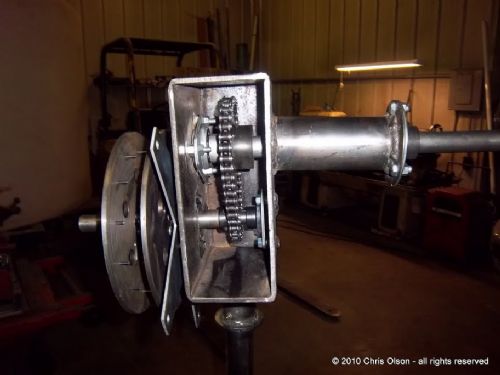

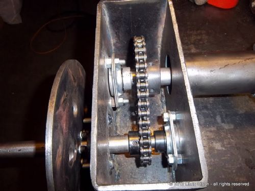

I cant find chris olsons original build posts so this will have to do. from memory it was first posted on fieldlines
it is his first chain driven axial flux build. the cogs, chain, self centering bearings and locking collars are all good quality standard issue off the shelf stuff. I dont remember how the blade hub and rotor were attached, I suspect it was with a taper lock centre. The only catch is the cogs would have a keyway cut into the shafts so there is a tiny bit of milling involved.
Anyway, this is how I would build, most of the machinery I work with is based on this combination of parts, it is pretty bombproof, quick, standardised and cost effective.

flc1
Joined: 20/11/2011
Posts: 242
Posted: 10:37pm 04 Apr 2016
thanks Yahoo2, thats a good solid looking piece of work, those bearing housings look like a two piece setup,,a front and back?? I think I will be useing somthing similar to that , they can have holes drilled to fit the stator.Edited by flc1 2016-04-06

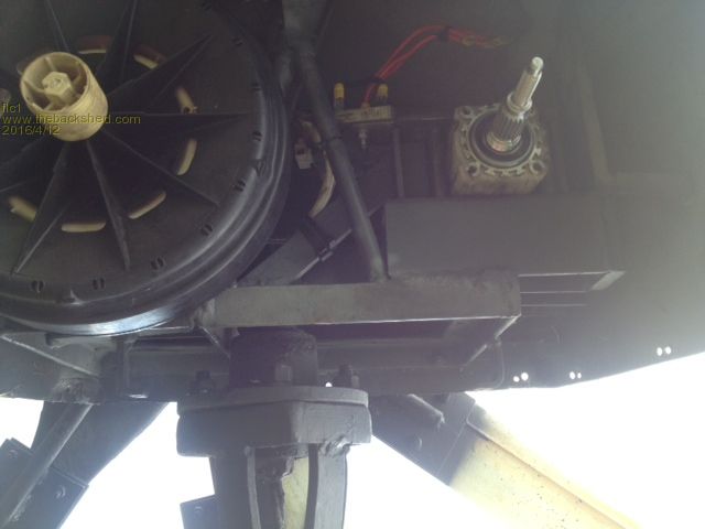

flc1
Joined: 20/11/2011
Posts: 242
Posted: 09:43pm 11 Apr 2016
double stator setup.........with 1 stator removed, so I can repack bearing with grease.Edited by flc1 2016-04-13

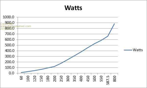

Hi Fred
Here is a power output graph of a single 36 pole Delta F&P stator with black rotor cap operating under optimum conditions. RPM is on the horizontal axis.
If you see graphs with a steeper curve the stator is operating outside it's optimum operating output.
David
flc1
Joined: 20/11/2011
Posts: 242
Posted: 05:11pm 16 Aug 2016
thanks for that David, some more good data

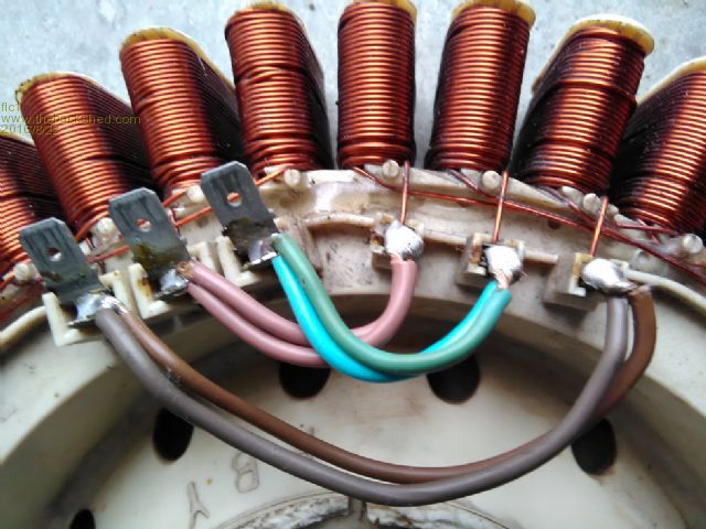

Posted: 08:18pm 21 Aug 2016
photo of a stator that is uncut and wired in delta

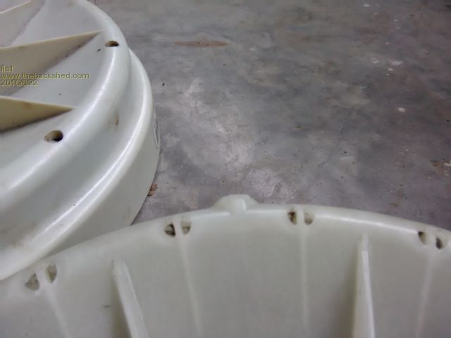

Posts: 242
Posted: 08:39pm 21 Aug 2016
photo showing the diffrence between a arrow head f n p rotor cap and a standered f n p rotor cap, the arrow head rotor has 5 small knobs around the outside edge of the rotor cap, knob can be seen in photo, the standered older type rotor cap in backgound. Arrow head rotors have very little cogging because of the arrow head shaped magnets,as explained on other pages in the back shed forum,and the 36 pole comes from the factory with rounded pole ends( all ready decogged), good for windturbines. The black f n p rotor cap is usually on a aluminum stator,so if you come across a f n p washing machine at the dump and it has a arrow head rotor cap, it will most likely be a copper wound 36 pole stator,thats good,and one with the black rotor cap will most likely be a 36 pole aluminum wound stator,so grab the black rotor cap(can be hard to remove because of stronger magnets) but leave the stator that it is on,most likely aluminum windyings,good for nothing. The aluminum stator usually has the letters A L stamped on it. The black rotor cap can give you about 20% more power out of a 36 pole copper stator when compared to the arrow head rotor cap. hope this info is of some use to sombody. Edited by flc1 2016-08-23
