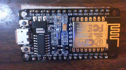

Posted: 04:46pm 04 Nov 2015
Wow.. I ordered the SP12E DevKit v2 boards from (USA) Banggood and they arrived from the vendor in just 2 days..! Taking a look under the Mag-Glass, they seem to sport a CH340G USB converter on board. The WiFi module model is ESP8266MOD with Vendor code AI THINKER... I am still collecting websites and data on these...
With the USB and on-board 3.3 reg, I should be able to just "plug it in" and re-shoot the core with Basic... Will give it a go and see what happens... The modules come with the Lua code. I ordered 2, so will keep one untouched for now...
Nice toy..!!
EDIT: - Boy, this is getting confusing.. I am not sure how much Flash memory the module has and what "flasher" program to use... I love GitHub.. (not) but managed to get a copy of ESP8266Flasher.exe downloaded. I think this is what should be used for this type of module.. (i think)..
So, next, I tried to get the Basic code for the core at GitHub.. The ESP8266Basic.ino file.. What you get looks like the C code for the project... Is this the file you pass to the flasher program..? (i think not)... (head scratching)... Not sure how to proceed.. I will just try powering up the module for now (with Lua core) and see if I can get it settled in...
Any advice on how to get the MMISCOOL Basic code flashed would be a big help..!

Posted: 06:05pm 04 Nov 2015
Now I see why traffic on the site has spiked. And all of the feature requests.
As to the question about the flasher. It looks like your board has a flash button on it.
It also looks like it might be able to be power off of usb which is a great thing when developing and testing.
Download the flasher program from the http://esp8266basic.com/download/
Place it in a folder.
Run the flasher.
When you run the flasher it will create a directory called build in the folder you place the exe in. This folder has the bin files in it that can be flashed using an alternative flasher if the one from the web site fails.
Identify the com port number for your device and select it from the list.
Select the flash size. For your module in the picture it looks like an esp-12 on a nice dev board. The ESP-12 should be 4m for the flash size.
Hold down the flash and reset buttons down on the device and click the big "Flash" button in the flasher program.
Release the reset button about a second after clicking the flash but make sure to keep the flash button on the module pressed.
When the flasher pops up a notice with some flashing information you know you are done.
Open up your favorite terminal program and connect to the com port for your device at 9600.
Restart the esp. It should spit out a bit of giberish an then a nice "ESPBASIC VERSION x.xx"
At this point you can connect to the device via wifi (Network name "ESP") and program it with out wires. Simply point your browser to http://192.168.4.1/edit
the default password is blank so simply click log in.
You can configure the auto connect options by visiting the settings page. If you do this and restart your device it will connect to the network you specified.
To find out what IP address it was assigned look at the terminal when its booting up. It will spit out the IP address of the device.

Posted: 09:16pm 04 Nov 2015
Welcome to the forum, mmiscool. Am just getting started with your port. Thanks for the work, it seems like this is going to be fun. I see Matherp got the I2C working, so can't wait to play with that.
Zonker, I picked up a couple of boards similar to yours from banggood. I did the proceedure that mmiscool outlined. However, I did not have to hold any buttons at all. I used the 64bit version of the nodeMCU flasher and pointed to the build folder and used the 4M bin file. Worked fine.
See if that works for you...Edited by viscomjim 2015-11-06

Posted: 04:28pm 05 Nov 2015
Thanks mmiscool for the walk through on ESP shooting..!
It seemed to work like a champ... Just got home, so I will try to get the radio attached to the network... I have TeraTerm sitting on the USB side.. If the module sits there awhile, it seems to startup the "access point"... I have a U-verse setup, with the radio sitting on the router. So, (i think) will try to attach the PC (sitting on a hard-line), to attach to a new network called "ESP".. Maybe this is one of those "RTFM" moments..
Anyway, Welcome to the forum..!! And, thanks for bring a very nice toy to the party..! Thanks Jim and Pete for getting this started..! GOD.. I love new toy's...

Posted: 05:58am 07 Nov 2015
Afternoon Gent's...
I got the EPS module to respond as an access point of the wife's HP panel PC using it's WiFi radio. It seems to be working fine in this mode.. Is it possible to get it to attach to the routers radio and become part of the home network..? I tried the other mode of logging in, but can't seem to get it attached...
I am kind of a dummy on this as I don't have any working knowledge yet..!
The website manual is kinda lacking in "dummy" (step-by-step) instructions...
If I can get the module to attach, then I can just log into it and start coding on any PC in the home network...
I am also confused on the modules "modes of operation"...
I understand so far (i think ), that when used as an access point (wap), the module will appear on the (radio equipped) PC's network list. If the module has a program saved previously, it should be running inside the module. When you log into the ESP network and open the web browser, you should see the GUI for your program "doing it's thing"... If so, I'm not sure how you would break out of program and get back into the editor... Maybe a different IP address inside..? Not sure...
Anyway, I'm not sure if the other mode of login using router based network attach is the same type of functionally or not...
I would like to learn more about this WiFi system and how to create web based GUI interfaces with MicroMite based slaves connected to the WiFi module as the system status monitor... If attached to a router, can you get to the modules GUI from any PC on the planet..? This would be awesome and I suspect that this is exactly what is provided... But, do I need changes to the router to create a "pinhole" for the module to be seen from outside the home network..? And if so, How would I go about doing that... (total dummy here)...
Any help clearing the fog would be great..!!!
Thanks Gent's..!

Posted: 07:39am 07 Nov 2015
To connect to your home wifi goto the settings page and put your wifi network information in the section for station mode. Save the settings. Connect the module to your computer and pull up your serial terminal and set it to 9600. Turn the module back on and if you were successful it will spit out the ip address that can be used to access it on your home network.
To get back in to the editor goto http://moduel ip/edit
if you go to http://moduel ip/
it will return the page from the currently running program. To disable the admin menu bar you can go to the settings page and check the box to disable it.

Zonker
Joined: 18/08/2012
Posts: 772
Posted: 09:57am 07 Nov 2015
Thanks much Gent's for the step-by-step on the hookup..! Once I found the router IP address and wep key... I just typed them in and the attach went off with out a hich..! The TeraTerm screen did spit out an IP address and I used the browser to check... Sure enough, the screens are the same as in the wep mode of operation...
I think where I got screwed up, was trying to go through windows network stuff instead of just entering the router network settings... Yikes..!
OK... Now for a little playtime.. We can now attach LCD based MM's and let them talk to the serial port of the WiFi module... (sweet)... I am going to have to brush up on the "html" skills again...
