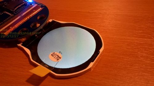

kiiid
Joined: 11/05/2013
Posts: 671
Posted: 08:34am 27 Dec 2015
Nothing again, unfortunately

Posts: 12266
Posted: 12:42pm 27 Dec 2015
  Quote  Nothing again, unfortunately
Have you a scope to check that all the control and data lines are correct and waggling? All wiring must be as per SSD1963 for the 64-pin MM+
RESET - single low pulse at initialisation then high
RD- high
CS - Low
WR - very fast negative pulses
RS - low and high with slower timing than WR
DB0-DB7 all showing movement
IOVCC and VCC = 3V
If you can find/check them IM3-0 should be 0b0011
The new initialisation sequence is taken from code that is purportedly working for the R61505V so should at least blank the display ready for use

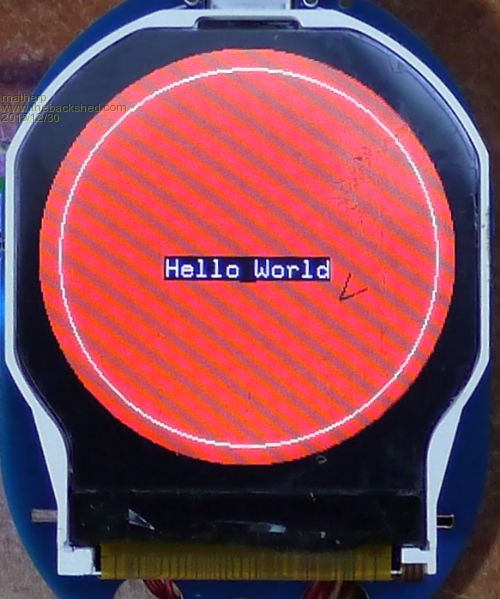

@kiiid
Was looking a your round display Pix above... What kind of PCB is the display connected to..? I was wanting to order some of round R61505V based modules from Ebay, But it looks like you have one mounted to a PCB with some kind of plastic mounting frame for the display.. Is this your creation..? Looks like a SD card connector and other parts there... Just wondering...
I was hoping you got the new driver from Matherp running OK....
@Matherp..
Does the Ebay selection I have look like a correct choice for the round unit you are creating the driver for..? If so, I will get 2 of them ordered of testing... I want to create a Rs-485 slave display using the rounder with your awesome Gauge display code to create a small single PCB that fits inside an "old school" aircraft round 3" gauge case... Hope this all works..! Ed, with his 3-D printer has the case model working, but we need final inside PCB mounting points. If we can get this round display to work, the whole assembly should mount neatly to the front of the gauge face plate, with a simple back shell with a hole to let the 4 pin connector out the back... Could turn out awesome...
I will keep a keen eye on this thread...

but now the display does not initialize ie grey screen
Are you running 4.7b37?
Just tested again on a new install and it works fine for me. Try a low clock speed if no joy (30MHz).
Kiiid: You could also try a very low clock speed (30MHz) on the R61505V
Note: in both case you will need to rename mm.startup to something else and run it manually after reset and changing the clock speed to load the driver
jman
Joined: 12/06/2011
Posts: 711
Posted: 11:18pm 27 Dec 2015
Yes
I slowed it down and success at CPU 60 it works (Yippee)
at CPU 80 or above no go with CPU 80 the LCD does initialise
but the display is all garbled.
So it seems the LCD is SLOW :(

Joined: 11/05/2013
Posts: 671
Posted: 12:58am 28 Dec 2015
  Zonker said   @kiiid
What you see in the picture is a small board that I have designed for this display. It has a MM+, uSD, and a couple of other features. Since it is still in a very early stage, I can't announce any details yet.
The LCD itself is a thin module with white plastic shell on the bottom, that's part of the module, not mine.

Posts: 12266
Posted: 04:36am 30 Dec 2015
  Quote   I thought the above driver was for the display and was now working
Zonker
The driver for the ILI9325 works on both 44-pin and 64-pin
This driver is similar but not the same as the R61505V. I've produced a driver for this but it is not yet tested.
It transpires there are two variants of the mounted display: the TFT1P2477 and the TFT1P4967 (both use the R61505V controller).
These need different wiring. I think Kiid's board is wired for the TFT1P2477 but the one he sent me has a TFT1P4967 mounted which I don't think can work irrespective of whether the driver is correct.
I'm communicating with him off-line and will update when we know more

Posts: 12266
Posted: 05:23am 30 Dec 2015
  Quote  Aaah, please don't say that!
I'm afraid so:
The banding is just an artifact of the photography

Posts: 12266
Posted: 06:35am 30 Dec 2015
  Quote  How did you get this one working? Using DB8-15, I guess, and high on pin 26?
Yes
Tested code for the R61505V is attached.
There is something strange about the way these displays address - I assume it is the same for all versions but it means I have had to do some address mapping in the CFunction. This is transparent to the Basic user except that MM.HRES and MM.VRES are both set to 230 although the display is effectively 220x220 (with the corners removed).
The only effect is that the centre point on the display is 110,110 for all orientations and not MM.HRES\2,MM.VRES\2
C Code attached. This includes conditional compilation for 44-pin, 64-pin, ILI9325, R61505V.
2015-12-30_163343_ili9325.zip
sub mm.startup
pwm 1,1000,50 'needed for backlight if implemented as PWM
R61505V_V64(PEEK(CFUNADDR R61505V_V64),2)
end sub

Thanks a lot!
That was a priceless help
