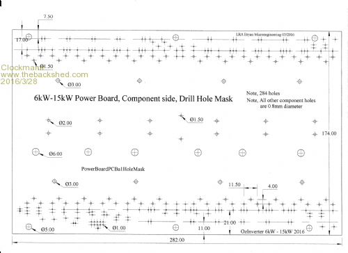

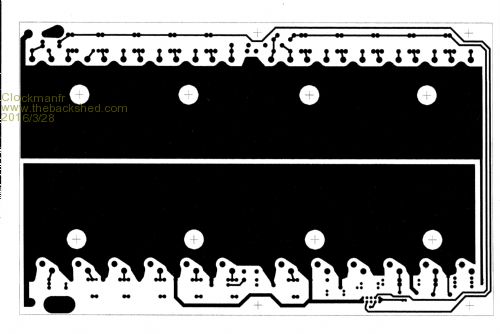

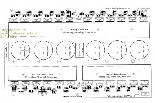

and
and Drilling mask......
This is a double sided board, extra thick copper, size is 282mm x 174mm.
Clockmanfr
Joined: 23/10/2015
Location: France
Posts: 437
Posted: 11:31am 28 Mar 2016

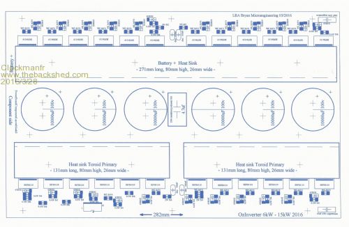

The General layout.

Posted: 11:34am 28 Mar 2016
And the final silk screen mask.....

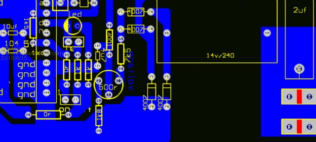

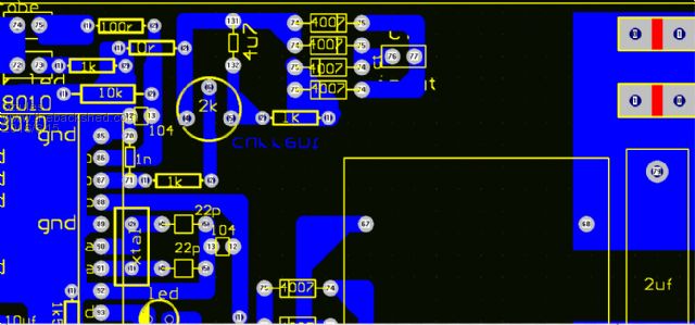

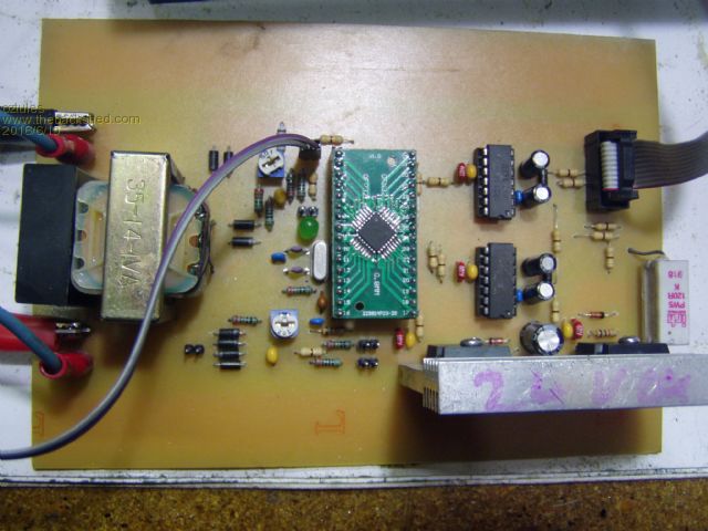

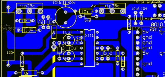

I have settled on this for the time being.
It does everything I want, others may want more/less.
1. It has on/off via pin 6
2. It has temp input as well for disaster situations where fan fails and temp gets out of hand
3. It has off board pins for power led
4. It has off board pins for status led
5. It uses a current transformer coil
6. It uses an isolation transformer for the voltage feed back.
7. It uses a simple voltage supply using the TIP35c... simple, and effective and fails off not on.
There are two things that I don't like particularly.
1. The voltage drifts in the first few minute from say set 230 to 234v... then stabilizes rock solid at 234 or whatever you set for plus 4 v after the first 5 minutes.
Can't find what is heating this up or what ever causes it. The heat gun makes no difference once stable... so maybe not heat but what else I can't say.
It is stupid simple, which makes finding the fault either dirt simple or impossible. ( inside chip)
2.If you slowly raise the voltage of the supply from 0v to 50v or so slowly, the chip hangs.... no idea why...but it is internal, and does it when you slowly introduce the power to it.
If you splat the terminals which is pretty standard, then no problems forever while it is connected to batteries.
I use a 10 ohm resistor to avoid the splat, and this is fine too, but if you go to say 100r, then it will charge up, but no action... so keep in mind.
Neither of these two problems are show stoppers by a long long way. The plus attributes easily out weigh these foibles, but they need to be mentioned.
Apart form that, these things are quick and simple to build, and run beautifully... and create no fuss , but just run anything thrown at them... really remarkable little devices.
I won't be going any further, as I cant see what else you could ask for in a home inverter. Those that like lots of bells and whistles designed to make them look very complex will be disappointed... they are simple, and work as well... in fact better than all I have encountered as a straight inverter.
It draws a very modest idle current ( 30 watts or so), and go for excursions over 10kw without any worry.... very very versatile.

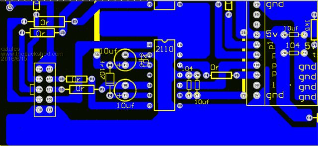

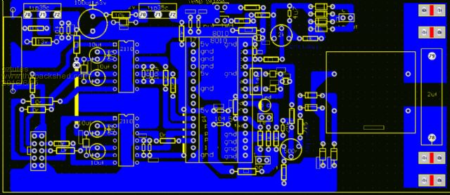

Ok here is the final PCB I will use from now on
The board complete:
top left
top right
bottom left
Bottom right
oztules
Joined: 26/07/2007
Posts: 1686
Posted: 03:49pm 14 Jun 2016

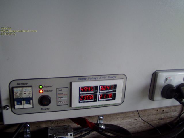

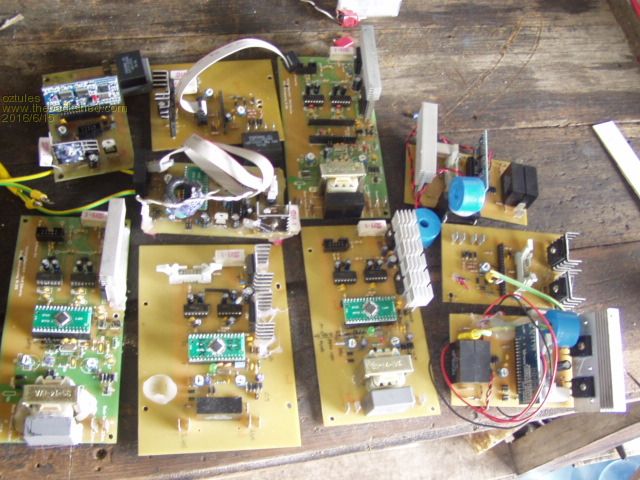

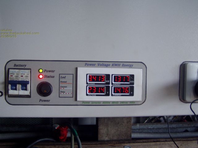

Now a pic of the board.
It took as few incarnations to get what I wanted, but they all work, and have all seen 10kw bursts.
Doing a few kw in a aerosharp 3kw carcass.
And throwing the whole house at it with near everything turned on I can find, fridges freezers, telly's, jug, and hot water service simultaneously... what else can I do.... By the time I went outside to start the compressor as well, the jug had finished, so it did that too less the jug...
What can I say.... the simple thing just works without any fuss at all.
I am running at 232 volts or thereabouts... slightly easier on the battery and no change in the house from what I can tell.
Notice the voltage drop with the extra few kw..... not too shabby...
So this little board and a fet board and tranny and a box and thats it..... for a inverter you probably have not seen the equal too inmost cases.
and the pdf... it won't post here so
http://www.anotherpower.com/board/index.php/topic,1116.msg12315.html#msg12315
............oztulesEdited by oztules 2016-06-16

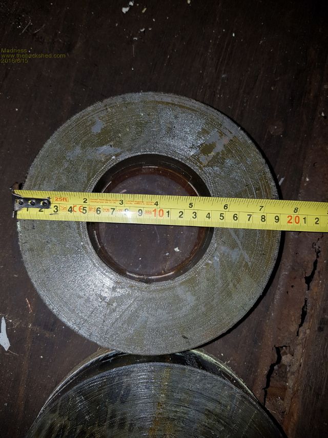

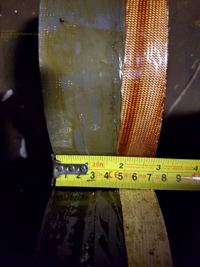

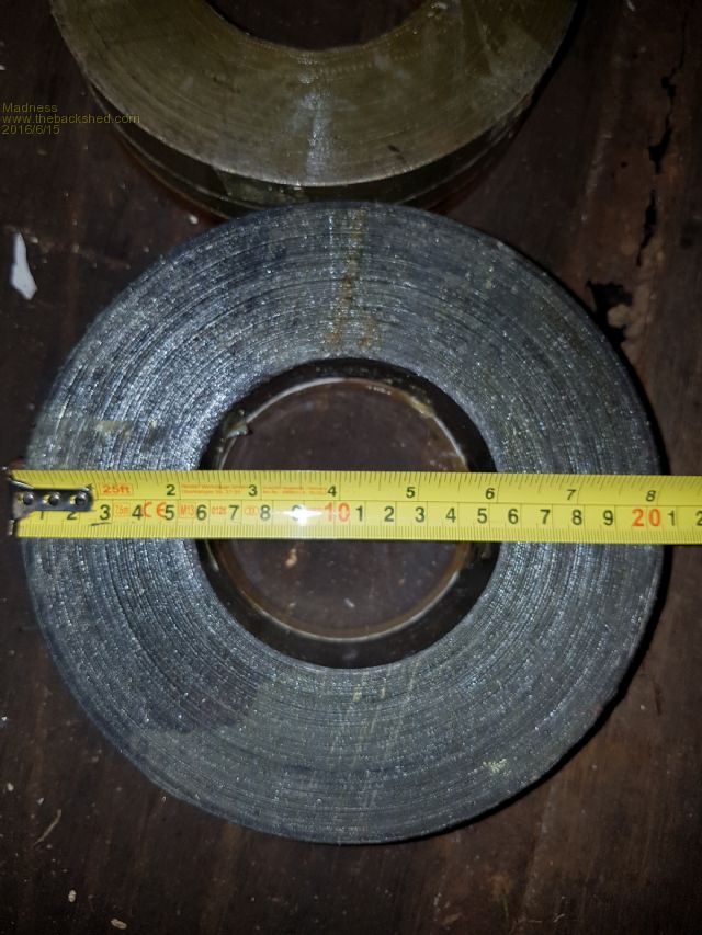

Just finished unwinding the second Torroid and the bloody thing is is different They are wound differently with the one having smaller wire and 3 winding's in parallel in the primary and secondary, the other was wound 2 pairs and heavier wire.
Biggest problem is the core on the second one is about 15mm bigger diameter, I will have to unwind another but it is trap to watch out for the production date and the number at the start of the second line seems to be where the label is different.
Edited by Madness 2016-06-16
oztules
Joined: 26/07/2007
Posts: 1686
Posted: 10:10pm 14 Jun 2016
Mad.... this is not a deal breaker...
It is easy to remove some layers from the inner or outer to get them the same.
If you use the rule of thumb that 2800mmsq is 1turn/volt, then you can get an idea of what you will end up with.
What are the inner and outer measurements of the two cores...
Preference is to take some from the inner if that can be done to get to even... if the 15mm is on the outer, it is easy to remove, just no gain in the size of the hole... although generally that is about 100mm on the aerosharp.... which is good.
Suppose your initial turn/volts is about 1.14... 2 cores gets us to 2.3v/turn, if we lose say 15mmx50mmhigh , then we lose 15X50, then you will loose about .26v/turn... ie back to over 2v/turn... still pretty nice to wind.
The good thing about smaller holes, is there is more cross section per kg, the bad is you need some room to wind... just another compromise....
Grog, no..... not unless you do one.... other folks may want one too:)
Mad, in answer to your other question. Yes it is entirely fine to use enamel wire for the primary... but think about this.
If you use a wire size you can bend fine, say 1mm.... then if you use 40 in hand , you will still only get .5^2x1.414 or .7875x40 =31.4mm^2
I don't need to explain that 40 wires is hard to handle in this situation, and a single wire is easier, and yeilds bigger mmsq easily.
If your really keen, get your 40-50 wires and put them in a heat shrink tube, and wind that perhaps, will still be a massive ask without a machine.
The W7 units are this way, and so are the PJ units.... they need it as they get very hot, I have not seen one of these bigguns get over 55C in the summer even.
If heat concerns you for some reason, use silicon coated wire, I think the Aussie ones use that.
But hats off to you if you can get 40-50 wires in there without damage.

I have some enamel copper wire here that is about 2mm so that would be better than 3 mm2, that would need 15 in hand. Any way I get your point, the PVC wire would not take long to wind and easier to terminate. I am going to the motor rewinders tomorrow to get some high temp epoxy, I will see what they have in flat enamel copper strip also
Cores are 190, 95, 70 and 205, 100, 70, I would have to remove some off both and get 190, 100, 70. Correct me if I am wrong but that would be 6300 mm2 so 2.25 volts a turn with a 100 mm hole so all good. I was thinking I would have to use another core, your not just a pretty face Oz.
