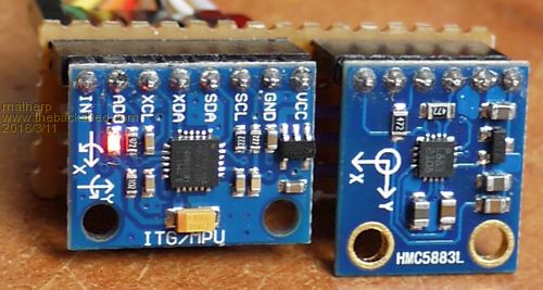

Does anyone know if this chip can be used as a Gauss/magnetometer as the post name implies ?? I looked at Honeywell's data sheets and couldn't find any info or app notes on it other than "12-Bit ADC Coupled with Low Noise AMR Sensors Achieves 2 milli-gauss Field resolution in ±8 Gauss Fields".
I found a break out board at URL=https://www.sparkfun.com/products/10530. (Sorry, couldn't get the hyperlink to work.)

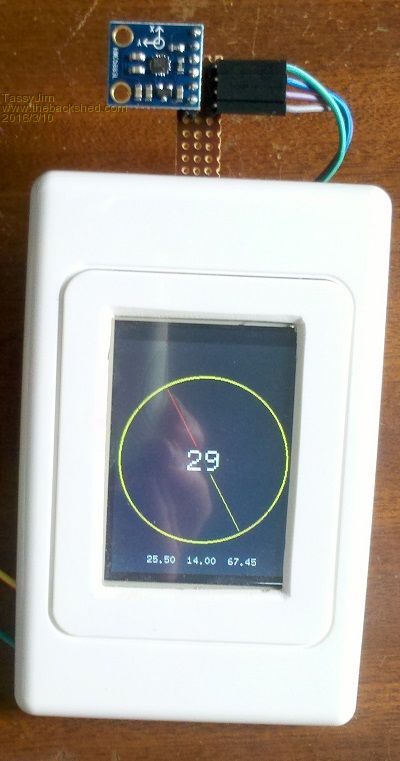

Speaking of which, this program draws a compass needle and gives bearing an the 3 components.
It requires a ILI9341 in portrait mode.
The HMC5883L is oriented with the x axis pointing 'ahead' or 'up' and the y axis to the left.

Posts: 6632
Posted: 05:36pm 09 Mar 2016
The sensor is mounted up front to be away from big hands.
Red points to magnetic north and the current bearing is in the centre.
The 3 numbers at the bottom are the three x, y and z vectors in uT
It is fun playing with a reed switch magnet in close proximity.
You can also point the 'compass' up (down in the northern hemisphere) to maximise the x reading and minimise the other two. This gives you the angle that the magnetic field is coming down at - about 70 degrees where I am.
At the maximum, I read about 56uT which compares reasonable well with the expected 61uT.
I will try it outside away from local interference sometime.
Compass combined with accelerometer is next on the list.

Thanks for posting the code all seems to work except when I move to compass through 90 deg. to point East it reads 135 Deg then South is 230 and west is 295 and then back to North Zero deg. I made the changes you mentioned. Is yours reading in a linear (or should that be circular) fashion.
Paul.
Edit BTW where did you get the case, by far the hardest part of a project.Edited by palcal 2016-03-11
Posts: 6632
Posted: 08:38pm 09 Mar 2016
I think your sensor might be upside down compared to mine.
When you rotate, does the red end of the compass needle stay pointing north?

I have mine with the chip facing up.
I also meant to ask why an accelerometer with a compass.
Paul
Posts: 6632
Posted: 08:53pm 09 Mar 2016
I re-read your post.
If I keep the sensor in the same location, it behaves correctly but if I hold the display in the same location and therefore move the sensor around in a circle, I get strange results. This is because I am too close to mag fields. A long power lead and standing in the clear will work better.
Keeping it level makes a difference too.
The 'case' is a blank electrical power outlet.
I don't have the luxury of a CNC miller but the Dremmel and a shaky hand does a reasonable job of cutting the opening.

An accelerometer gets your tilt/inclination. Together you can calculated the mag field in 3D.
We 'should' be able to end up with a compass that works on any angle.

I had my compass outside well away from any interference when it was reading incorrectly. I also had it flat on a table so it was not at an angle.
Paul.

With the latest code North is showing at about 40 Deg. When I rotate, the red line also moves by about 40 Deg.
Paul.

I also see that when pointing North the heading can read either 360 Deg or 0 Deg.
Should it not be one or the other.
Paul.
Posts: 6632
Posted: 07:21pm 10 Mar 2016
After:
heading = INT(DEG(Atn2(yh,xh))+.5)
add a line:
if heading = 360 then heading = 0
I have been trying to add compensation for tilt but not very happy with the results.
Two application notes from Honeywell give conflicting information.
I am using a MPU6050 to get the tilt OK but the formulas for correcting the X and Y mag readings don't seem to give me acceptable answers.
I think I will have to give it a rest and work on something else for a while.

Attached is a full AHRS implementation using MPU6050 and HMC5883 you may recognise some of your code in there
The issue I'm not sure of is the relative relationship of the x, y and z axis of the two sensors in the call to the sensor fusion routine
MahonyAHRSupdateMag(gx, gy, gz, ax,ay, az, -my, mx, -mz)
I'm using x=-y, y=x, z=-z and it seems OKish. I've also got a version for the MPU9250 but bizarrely this chip is also a composite of two dies with the magnetometer separate and the axis aren't aligned in it either
