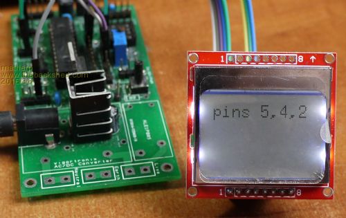

I'm having the same problem here Paul and I'm using the same pins as you, i.e. using:
NOKIA5110(5,4,2,&HBb,1)
on a similar setup - 28pin MX170 MMBasic V5.1. I've checked the pins three times now (so I hope I'm not stuffing things up) and I'm using the uM's pins 3 & 25 for the DIN & SCLK of the 5110. I've also tried two different contrast settings, &HBb as per you and Peter, and also &HC8 that works OK with JMan's code on the same screen; I unloaded then reloaded the driver in-between. Neither contrast setting works though.
In the Teraterm session below nothing shows on the screen after issuing either of the TEXT commands - I wasn't sure whether The SPI OPEN was still needed with Peter's driver. Then I wondered whether I still needed to issue the chip select commands but as you can see it gave the error on Pin 2 as soon as I tried to pre-set it.
One thing I wonder about though is that my setup with the NOKIA has 10K resistors on all control and data lines, i.e. SCE,RST,D/C,DIN,SCLK as per the original circuit that works OK with JMan's code. Is there an issue with this maybe?

Posts: 12102
Posted: 10:12pm 07 Mar 2016
I've just tested with your configuration and it works perfectly for me
sub mm.startup
NOKIA5110(5,4,2,&HBb,1) 'DCpin, RSTpin, CSpin, Contrast, orientation
end sub
Pins 4 and 5 are the ICSP pins - do you have anything else connected to them?
Also try running at "CPU 10" to see if your display is slower than mine or Kermess's

Well, it's all working fine for me too now Peter and it looks like wiring was my problem.
I removed the connector I'd made up for the Nokia a couple of years ago (which had 10K resistors in all the control and data lines) and just rewired it all direct to the uM via standard DuPont jumpers - Voila, suddenly all was well! I don't know whether the connector was bad or the resistors maybe caused a problem with the CFunction driver. It worked with that connector previously with JMan's code but it's certainly possible I've created a problem with all the jiggling around.
I'll have a play with the new font capability tomorrow - thanks for your help with it and apologies for the red herring on my part.

  Quote  which had 10K resistors in all the control and data lines
Were the resistors in series in the lines? If so then this is almost certainly the issue. The SPI on my code is running fast and charging the pin capacitance through a 10K resistor would slow the edges down too muchEdited by matherp 2016-03-09

  matherp said   Were the resistors in series in the lines? If so then this is almost certainly the issue. The SPI on my code is running fast and charging the pin capacitance through a 10K resistor would slow the edges down too much
Yes they are so I guess that's a lesson learnt. JMan's code was implemented in MMBasic running on the MX150 before we had CFunctions so it would certainly have been running much slower.Edited by paceman 2016-03-10
