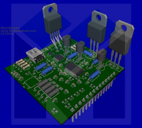

Posted: 07:59am 07 Apr 2016
I have redrawn the schematic in Diptrace as i like my colors.
2016-04-07_183618_DipTrace_Schematic_-_POWCCV_A.pdf
I would appreciate some extra eyes to check if it is correct.
There are also a few parts without specific values, like a zener diode and some resistors and caps. I will make a list of them shortly.
The challenge is to get it on a 50x50mm pcb.
My needs are more modest as i only want to have a maximum input of 12v and only need 9v or lower with about 1 amp maximum output. Most cases will be to have 5v or 3.3v with a low amperage to test circuits, and up to full power (1A).
I probably can use some more light weight components, but i first want to make sure the schematic is correct.
I also am considering a version that uses only a fixed 5v and 3.3v. Controlling the maximum allowed current is still the main task.
Edited by MicroBlocks 2016-04-08

If you can get that into 50x50 it'll be amazing Jean. One tiny thing on the schematic I can see is a missing trace on U1 (current shunt monitor). The rest is way beyond me though so maybe Robert or someone else can chime in.
Greg

Posted: 07:57pm 07 Apr 2016
Greg, Which trace would that be? I thought that was correctly wired.
This design has many parts i am not familiar with so it will be a learning curve.
A 49.75x49.75mm PCB seems to be possible.
After some fast placement (which must be improved on highly) all the parts seem to fit. No traces yet, just placement by ratlines.
First thing to do is to get all the part packages right, especially the capacitors need to be sourced first to know for certain which package is the right one.
Also for the resistors i need to know the tolerances and which side (0.5w or other).
Edited by MicroBlocks 2016-04-09
Posts: 12026
Posted: 09:29pm 07 Apr 2016
The easiest way to check your schematic is to compare the netlist. I attach then netlist of my original.
2016-04-08_071631_netlist.zip
The 1 ohm resistors need to be 1W, the backlight dropper 0.5W, all others can be 0.25W or greater. Tolerance doesn't matter too much as inaccuracies can be tuned out in software.
The zener is probably not needed it is just there to protect the uP - I used 5V1.
I strongly recommend having the 7805 and the LT3080 on the same edge so they can be connected to the main heatsink. The 3.3V reg can be separate but should still have a local heatsink.
The output of the IN169 is set by the combination of the parallel shunt resistors and the gain resistor. You can use 2x 1ohm + 2x 10K or 4 x 1ohm + 1x 10K. The latter is preferred. My layout includes pads for both options.

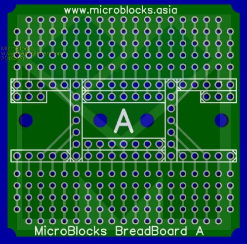

That looks good as a start but don't forget you will need at least 4 mounting holes..
MicroBlocks
Joined: 12/05/2012
Location: Thailand
Posts: 2209
Posted: 02:09am 08 Apr 2016
Hi Mick,
I have a 'system' for bread boarding in development so i use a 50x50mm grid for mounting.
like this (shown is a carrier for prototyping with my other modules)
It also has holes in the center and two on the side to allow for other design to at least have 3-4 mounting holes.

Posted: 02:41am 08 Apr 2016
Thanks Matherp, i will use the netlist to check it.
And having the right wattage for the resistors is great to make the right footprints.
Chronic, that is one mighty interesting chip. More food for thought. Thanks.
