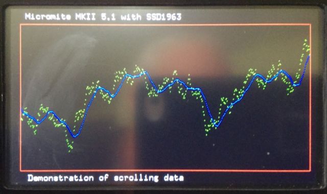

davematt
Joined: 27/09/2011
Posts: 55
Posted: 05:09pm 07 May 2016
Peter, I think I'm getting there... The attached is thanks to your help in several different areas, I'm sure you'll recognise the derivation.
And yes, I would have completely missed the GPS solution. Back to work...

Rolling average of directions is hard because of going through from 359 to 0
Don't average the absolute angles, average the deltas/changes.
davematt
Joined: 27/09/2011
Posts: 55
Posted: 03:33pm 08 May 2016
This can't be right!
With a bit of smoothing the heading values settled down nicely at walking speed, but the compass needle behaved very strangely. So as a test, I disabled the GPS stuff, and set the main loop to increment the heading by one. The compass needle started pointed West, and then rotated smoothly a full circle in 60 degrees. As I say, this can't be right! Either I've made a silly mistake (v possible) or there is something amiss with the needle drawing routine. Please can someone smarter than me take a look?
DavidEdited by davematt 2016-05-10
