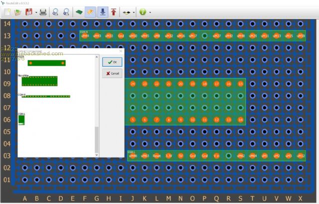

Hi Konstantin,
Just been playing with some layouts before ordering & having an issue.
Have a couple of CG Microboards & SnadPics and want to use the boards on those.
I started creating the connectors as components, but am finding one won't save correctly.
CGM-L & CGM-R are the 2 pin headers on the board; CGM-R saves to the library Ok,
but CGM-L saves as a large block with just 1 pin.
Any thoughts?
Phil.
Edit, bit hard to see the bottom component in the image; attached it as a zip.

Please note that with the Arduino/Shield PCB layout that not all of the pins are placed .1" apart.

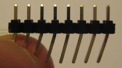

  CircuitGizmos said   Please note that with the Arduino/Shield PCB layout that not all of the pins are placed .1" apart.
Yep,
I'm on top of that one.
Using this technique.
Bend them at 20°, push them back straight with the soldering iron.
Then bend the short side.
Works pretty well & would be even better if I routed a groove in something that doesn't melt to sit the strip in while pushing the pins with the soldering iron.
