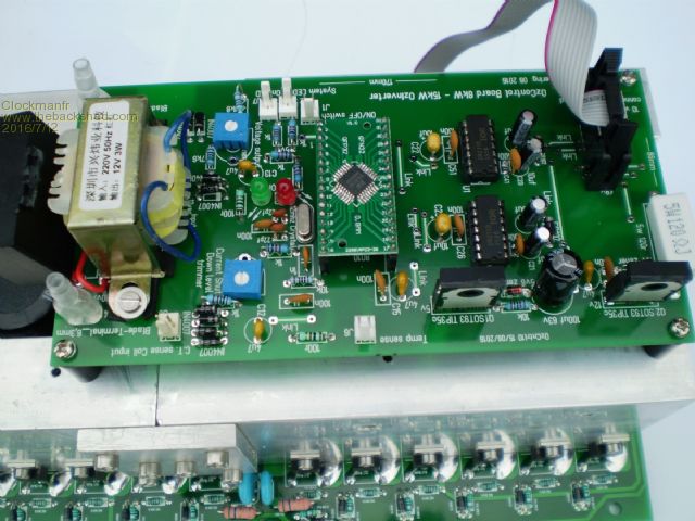

It is reassuring to here I am not the only one, I actually have that 2uf capacitor connected in the photo. It is the 2 black wires going off to the right, I will find some where to screw it to the case when I get to that stage. Also you will see the 2 N4007 Diodes connected to the output of the transformer sitting up at an angle, I had to drill new holes for them. You can see the transformer I have used which is a PCB type would be a better option in my opinion.
That part of the board certainly needs some rearranging, there is space above and below the transformer that could made better use of. After I get this one up and running I plan to do a version with an Arduino which I will use for sensing current, voltage, temps etc. This will then control fans, over temp shut down (or possibly partial shut down first of non essential loads). Other option I am thinking of is data logging and connecting it to my network, this will allow graphing of variables etc which is quite easy to with the Arduino.Edited by Madness 2016-07-12

Originally I made the first OzControl board 6mm longer, then I found out that nowadays the PCB manufacturer prices on size.
As you can see in this photo I have lifted the Isolation 220vac to 12vac transformer on to 4mm high spacers for this particular board and that is what I will recommend.
The 2uf capacitor is on and firm, but just looks untidy. Some time I will give the board another 6mm in length to be more pleasing to the eye.

Hi Clockman,
Where you doing a double sided version also?
I will be making a double sided version and including an Arduino and sensors as well.
I see you have made some changes to LED and a number of items, looks very good. I still like the PCB mount type transformer though, even if it takes a little more space it is simpler to mount as there are no screws and that frees up space above and below.

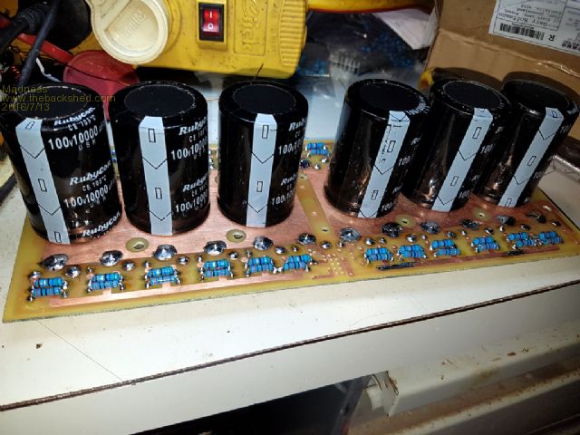

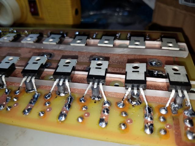

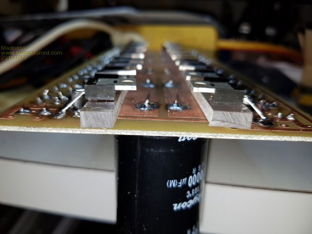

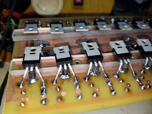

Have made a bit more progress after getting PCB etching sorted out.
Here is how I have mounted the mosfets so that they will clamp onto the larger Aero Sharp heat sink. The perspex that I have used has a working temperature rating of 80 degrees continuous and up to 120 intermittently.

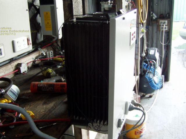

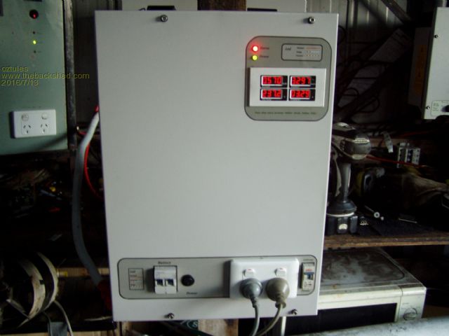

Mad... here is the 3kw aero with the inspire heat sinked board ( modified clockman board.
No fans, and testing showed today that 2.5kw for 1 hour raised the heatsink 18 degrees above ambient, transformer was 30 degrees above ambient.
I have set it for 5kw cut off... instant loads far higher.
Needs further testing when there is some sun to replace the electrons I waste.
...........oztulesEdited by oztules 2016-07-14

Posted: 10:31pm 12 Jul 2016
Hi Oz,
I have to say that looks very professional, people will think you bought it
How do think that transformer would compare to mine with 64 & 8 mm square windings?
Did you make those labels on the front?
A little trick I found when drilling the PCB's, cut a bit of masking tape about 10 X 20 mm, fold it put the middle of the long side on the drill bit a few mm above where it would hit the board so you have a 100 mm square flag. It blows all the dust just far enough away with out making too much mess but makes it very easy to see what your doing. Edited by Madness 2016-07-14

Posted: 12:34am 13 Jul 2016
Yes labels are from A4 label paper, then A4 clear label sheet.
It makes a very strong, and chemical resistant surface.
The transformer you have made is many times better than the one I built for this one.
I only wanted a 2-3kw continuous with no fan, so it is only having to support 10-15 amps so secondary is 6mmsq, and primary only need do 60 amps so 35mmsq. It has massive surge if needed, and would run 4-5kw for 30 mins I guess, still need to test this.
Yours is very much superior, and this is only a test bed to try different thermal ideas... like the massive heat sink.
Clockmans board is bigger than yours, so yours would be better for this topology, but Clockmans is very solid, and could easily cater for many blow ups without a problem with fiddly tracks... and this one should blow up I expect... that what test beds do I guess.
Also, this system we are using is very fast to pull the heat sink and fet board out to repair.. probably 5 mins tops.
Like the tape idea.... annoys the hell outta me. blowing away the dust all the time..
I kept the fets very close to the surface without spacing so that the legs are very very short, and only the wider parts are used really.. better current carrying I think, but no room for ferrites on the center leg...... does not seem to bother it.
I saw a unit on alibaba that used what looks like a larger egs002 type board, but it also did AC coupling to generators etc.... ie ups operation.
I could not find a decent source for the silicone rubber stuff, so used discrete mica, but a strip of thermal silicone would be nice.... probably not as good as mica perhaps but more friendly.
If the primary gets too hot... I will do madness thing to it with 2mm enamel wires

I had wondered about he legs on the mosfets and their current carry ability. Can beef up the legs by soldering extra wire to them, Removing the ferrites and spacer is an option too if they make no difference. It was a pain in the arse soldering them in like that with the ferrite on there, plated through PCB would have made it much easier. Also I will build a future version with the 247 version of the mosfets. This board is a bit rough, I want to test it before getting some more made.

Hi Gary,
A reply to your questions....
"Where you doing a double sided version also?"
In the last picture I posted of the complete Electronics 6-15kW unit PCB for the OzInverter. The OzControl Board on top is the latest design and yes, its a double sided board. Double side boards are only a few cents more each.
The fundamental design is unaltered as I also produce the board as a single side simple board for home etch. So the double side board just incorporates the Or/Links/jumpers on to the top surface. The board could end up in any environment so I keep things robust and chunky tracks.
I also do the Silk screen as a painting by numbers, lots of info.
Which leads me to PCB manufacturers. .... I had been using these folk, http://www.shenzhen2u.com/PCB the boards are okay and the manufacture sticks roughly to the time of delivery they quote.
But, but, the latest batch of 6-15kW Power Boards, double sided and double copper thickness has poor silk screen printing. They were struggling on the previous batches, because of the double copper thickness valleys and troughs on the top of the board and small print. Folk get the printed out version of the silk screens so there shouldn't be any issues, they just need to check.
Regards the 220vac to 12vac 3w transformer..... I did look at PCB direct mount, but the pin outs are specific to each transformer, and folk around the World can only get what they can get. So my holes are spaced for different sizes and types. I like the open types as I can mount them on lifting up spacers if need be.
Also around that area there is no copper, so the mounting screws, 3mm, can be repositioned if need be.
