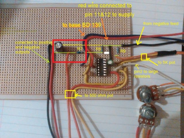

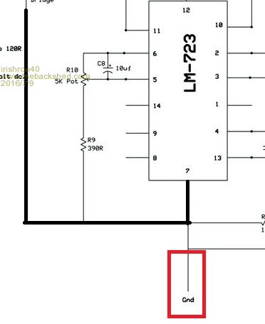

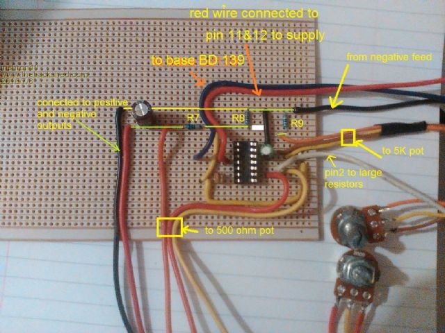

i know. i am sure problem is on circuitboard.
1)
on diagram it shows a line to GND under pin 7.
i dont have that one i see, as i thought pin7 is getting ground alleady comming from the bridge rectifier,
( surely that cant be the problem can it? )I do have a neg lead from capacitors and from c10 to neg output terminal
2 I have a thick positive lead connected between the R5 and R6 and my positive output terminal.
the positive output comming from R7, C10 & the 500Ohm pot< see attachment)
bd139 and tip41c are def connected correctly and so are the large resistors. so I realy feel its somewhere here with a lead connection maybe at the wrong spot that causes the problemEdited by irishron40 2016-07-09

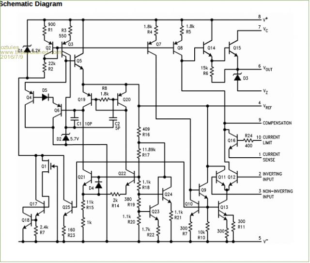

oztules
Joined: 26/07/2007
Posts: 1686
Posted: 06:52pm 08 Jul 2016
Pin 4 may not be as high an impedance as I first thought looking at this.
So maybe you will need to go lower impedance again... but maybe still higher than 390r:120r... may be just double it and the power dissipation will drop 4 times.
I am at a loss to see how it works in practice. I expected an op amp there, nut it is a sort of op amp, where as pin 2 and 3 is more what I expected internally.
The fact that it still worked means that it is fairly high impedance, just not as high as I had thought.
I really don't know what to tell you yo do next, as I am not there... all I would try is to run it, and try to very gently load it up ( maybe 100r) and see what changes.
When looking for faults of any kind.... change is what I look for... then nut it out to see why it changed for better or worse... it is in this process I usually find the problem.
Curious... what is the input voltage?
.............oztules

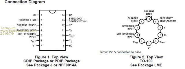

Posts: 6636
Posted: 09:31pm 08 Jul 2016
  oztules said   Pin 4 may not be as high an impedance as I first thought looking at this.
The pin numbers on your circuit are referring to the round can, not the DIP package.
oztules
Joined: 26/07/2007
Posts: 1686
Posted: 10:10pm 08 Jul 2016
Thank goodness for that Jim... as I could not see how that circuit would work in practice... it made no sense to me at all .. thanks for that..... I need reading lessons from the looks of it.

For starters draw your circuit on paper as you have constructed it, wire for wire link for link, component for component, etc.
Do not look at the schematic i gave, then compare the two drawings.
When you quote this wire is connected to that point means nothing to me just confusion. So draw the circuit as you have built it.
There is a few solder joints on your board that looks close to bridged tracks so check them.
Some of your drill points on tracks to place a break might need checking, that there is not a micro copper fiber remaining causing a bridge between tracks.
The problem is a construction error somewhere, albit my crystal ball has its own faults and problems of late (it is Chinese made off ebay) so unable to pin point the problem.
one suggestion would be to remake the PCB as there is basically no componets to it.
Pete.

  Quote  There is a few solder joints on your board that looks close to bridged tracks so check them.
Hi Pete I did check every track and solder points with my continued test setting on multimeter.
it shows no shorts anywhere.
this is the 3th pcb i made, and each on same prob.
It seems to be working until I connect any form of a load
i just wonder this.
I have the outputs from the stripboard connected to output terminals. will the output from the large resistors not feed it back in there? or is that not possible

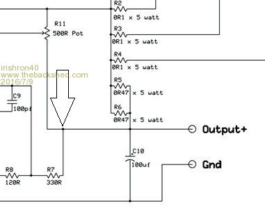

I started drawing as you sugested Pete.
Its amazing what you see when you do that
would this be the culprit??????
on my veroboard you see a red square.
it shows that the orange wire going to my 500 ohm pot is between the R7 and C10
on your drawing it shows that that the R7 is between 500 ohm and C10.
also wondering a bout the Gnd showing. why is this? isnt pin 7 allready getting ground from negative side capasitor?
could this be my problem ?
thanks
ronEdited by irishron40 2016-07-10
Downwind
Joined: 09/09/2009
Posts: 2333
Posted: 10:21pm 09 Jul 2016
Ron,
You are looking at my diagram as you trace you circuit out, that is not allowed, as you will think you have it correct and follow the same path as you are on.
Do a full drawing from your circuit only. Then compare the two.
As for the Gnd leg you refering to, it has no other purpose other than to indicate it is a Gnd supply on the schematic, simply i could not find a Gnd symbol when i drew the circuit, so used Gnd.
It makes no difference to where a junction in a circuit takes place, as a schematic is only a wiring diagram and not a exact road map of intersections unless indicated.
My guess is you have no current control to the circuit and the problem is located in this part of the circuit.
I can not see where and only you can.
For the fact you have burnt up R7 several times would suggest a problem there perhaps, and also by now would expect the LM 723 chip to be likely damaged by the past problems.
Pete.

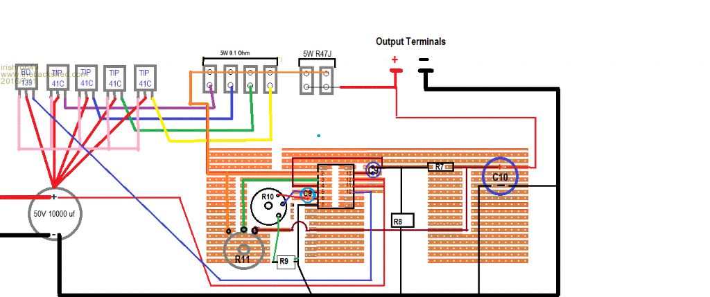

irishron40
Joined: 22/09/2014
Location: Ireland
Posts: 254
Posted: 03:43pm 10 Jul 2016
ok Pete . I drew this from my build. I hope you can see where I am going wrong.
I have 37 volt Dc going into board after regulated
thanks
ron

VK2MCT
Joined: 30/03/2012
Posts: 120
Posted: 04:55pm 10 Jul 2016
I'm wanting to check that that there aren't solder bridges between board tracks.
So - with the power off and the LM723 removed from its socket and both R10 & R11 (pots) centered ( not at either rotation end),
please measure between the IC socket pins and report:
IC socket Pin1 & pin 2 = how many ohms
Pin 2 & 3 = how many ohms
Pin 3 & 4 = etc
pin 4 & 5 = etc
Pin 5 & 6 =
pin 6 &7 =
Pin 7 & 8 =
Pin 8 & 9 =
pin 9 & 10 =
pin 10 & 11 =
pin 11 & 12 =
pin 12 & 13 =
pin 13 & 14 =
pin 14 & 1 =
John.Edited by VK2MCT 2016-07-12
