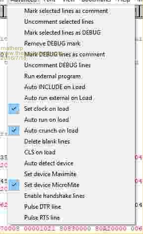

Posted: 02:40am 17 Jul 2016
some other idea,
please check if you have set the following within mmedit
mmedit
- advanced
-- auto crunch on load
-- delete blank lines
try again the transfer.
If this does not work split the cfunctions/sub between
normal and library memory.
1.) transfer the lcd driver to the chip
LIBRARY SAVE
2.) transfer the sdcard code together with the basic program.
Run it.
Nathan

The fault is definitely in your setup of MMEDIT and/or the serial connection which is corrupting the download. I just copy and pasted your post and got 312 blocks and the library save worked perfectly.
Check you have the syntax set to Micromite and try everything else suggested above.
Here are my settings
Edited by matherp 2016-07-19

Hi Peter
Success, I set up MMedit as you suggested.
Now get 312 blocks I have never used the crunch command before.
It all works thank you very much for your patience.

  Quote  It all works thank you very much for your patience.
Great - this seems to be a bug in the MM firmware related to CFunction loading. I'll report it to Geoff.
