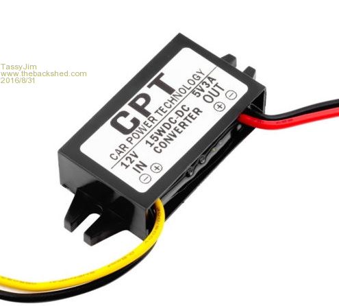

DEX links the PCB and the schematic so it would be unlikely that it can do anything with a bare PCB.
Once you have created a component for the modules the curcuit is very simple so would be an easy learning exercise.
You can then copy Grog's layout from the images he has posted.
@Grog,
I tend to use these fixed voltage devices but I notice that they are larger than your modules so I wont suggest that you drill a few mounting holes for them.
They are available in many voltages.
I will have to do as I suggested to thirsty and roll my own.
At the moment, I have them swinging in free air from the 12V supply terminals.

@ TassyJim - Yes, I have seen those encapsulated units on eBay, but never bought one. They too are a nice way to get several voltages. I wonder if they are just the same module as I am using, but set for whatever voltage, then encapsulated?
I like the idea of a fully adjustable PSU though, cos then if I need 7.5v for example, I can adjust one of the rails on the PCB for that, and leave the 3v3 and 5v intact kind of thing. Each to their own.
@ Phil23 - If you loaded up those encapsulated things to 3A they say they can handle, I wonder how hot they get..... Jim?

  Grogster said   If you loaded up those encapsulated things to 3A they say they can handle, I wonder how hot they get..... Jim?
The most I have used them for is about 2 amps peak.
When they are running 24x7 I go for less.
I like them. Being encapsulated, there is no need to protect them from mouse piddle.
I have had 2 fail. One when most things in the house went up in smoke due to the lightning strike and one recently for no apparent reason.
Like most things ebay, I like to have spares and an easy way to change them.
I do have the adjustable ones as well but for 3.3, 5 and 9V I use the fixed ones.

DO they get very hot at 2A?
Posts: 6624
Posted: 08:46pm 30 Aug 2016
They claim an efficiency of 96% so about 0.25W
I did some tests when I first started playing with them but have lost the results.
I will do some more tests when I get time but it will not be for a few days. Other events are getting in the way.
But at 2A they do not get hot at all.
I happily put them in a small case with a Raspberry Pi and a few other devices without any concerns.
They draw about 11mA no load.
