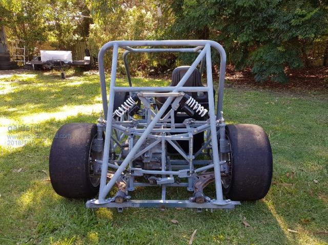

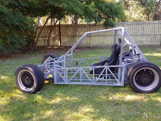

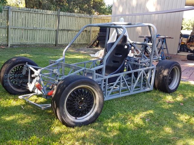

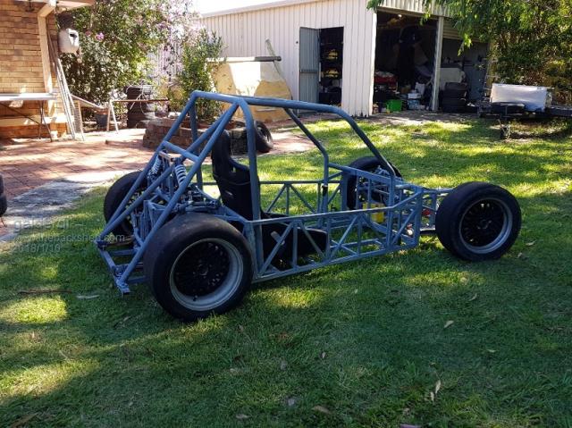

Here are the latest pics of my latest project. It is much the same as my last one but with some improvements from my learnings.
This time it will be around 440KG, rear wheel drive, mid engined, improved aero, improved suspension. I can't wait to drive it but I still have some work to do before it is ready to compete on Feb 11.

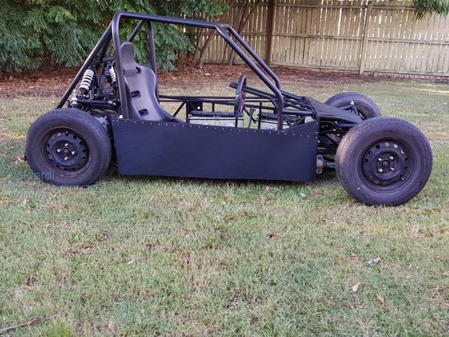

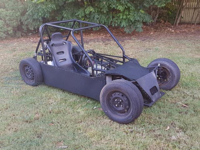

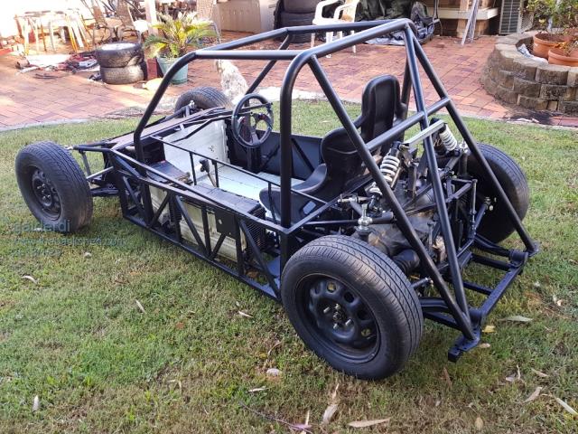

Posted: 03:25am 29 Jan 2018
These are a couple of the latest pics from my new project. I have struck some delays with my steering components. We'll see how it progresses over the coming weeks.

dwyer
Joined: 19/09/2005
Posts: 575
Posted: 10:46am 30 Jan 2018
Hi
I have a couple of questions out of curiosity,
Did you build the frame yourself and did you have to follow the CAM rules
Also the other usual questions are about AWD and is these are against the rules same
as anti lock brakes and traction control too. What happens if I had built one with AWD also what would this be classified under in motorsport
one final question is where abouts are you located?
I used to drive many motorkhana car clubs in Victoria in early 1970 and thinking taking my turbo territory into motorsport including drag racing as now l am back to single dad so now l am free man .
cheers Dwyer the bushman
galderdi
Joined: 12/08/2016
Posts: 99
Posted: 04:41am 01 Feb 2018
Thanks guys,
Yes I built the frame myself. The only exception is the bends for the cage.
Yes I have had to follow the CAMS rules. It follows the general safey rules plus the specific rules motorkhana specials. The rules for the frame are fairly basic, minimum length, must be solid, must have sides of a certain height.
CAMS have a list of pre-approved designs. If you build a cage from one of those designs there is no need for them to approve the design. But if you design something outside those standard designs you would need to get them to approve it before you construct it. My cage is a little overkill as the motorkhana cars only require a single hoop as a minimum. But I use the car for khanacross and hillclimbs so I would rather take the safer option. Plus I use the cage as a structural part of the chassis to increase ridgity.
AWD, antilock brakes, stability control and traction control are against the rules for motorkhana cars. These restriction don't apply if the features were delivered from the factory. I haven't looked at other categories but I am sure you could target another category where driver aids are allowed even in specially built cars.
I am located just north of Brisbane and mostly compete out at Willowbank. But I do try and attend a few remote events when I can.
