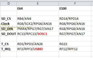

Phil23
Joined: 27/03/2016
Posts: 1667
Posted: 01:10pm 28 Aug 2016
Hi all,
I don't really understand what goes on inside these chips.
Only that there's different capabilities on each pin & that they seem to be in groups internally; the RA, RB, RC designations etc.
Thing I noticed between the E64 & E100 is the capabilities on some of the pins used is different.
I won't even pretend to know what SOSC1 & USBID mean; just an observation that other might see as relevant or not.
Phil.

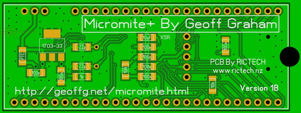

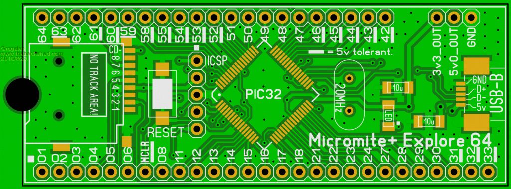

Posts: 10065
Posted: 01:31am 29 Aug 2016
PCB version is 1B if there is no USB jumper - J1. It should be this one here:
This version of the PCB does NOT have the supervisory IC on the PIC32 MCLR line, so it won't be interfering with the SD card operation. At least we can rule that out.
Watching this thread. Have been reading all your posts Phil, and others. If I have any suggestions, I will chime in, but at the moment I am stumped. If you really can't get any joy out of this one, PM me and I will arrange to send you another one - where I have tested the SD card fully first.
The only thing I can suggest to check is that the soldering is OK on all the pins to the uSD socket - perhaps the solder has not correctly flowed there or something.

  WhiteWizzard said  One question, is the SD card / Touch issue occurring on either SD socket, or only on one socket?
Any clues here?
