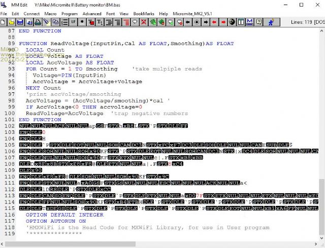

MikeO
Joined: 11/09/2011
Posts: 275
Posted: 01:23am 27 May 2017
Hi Jim , I had loaded the latest MMEdit from your web site 3.7 I think but it has given me grief a couple of occasions so i had to go back to previous version. It happens when i save the document,it seems to copy part of the program again plus a load of control char, sorry its not a very clear screen shot.
Edited by MikeO 2017-05-28
Codenquilts
Posts: 6621
Posted: 07:12pm 28 May 2017
Mike,
I can't look at it for a couple of weeks but what version of Windows are you running?
Showing control codes for part of the edit window is strange and not an area I have much control over. I suspect it could be the DLL that does those fancy bits.
I will experiment when I get home.
MikeO
Joined: 11/09/2011
Posts: 275
Posted: 01:14am 29 May 2017
Hi Jim, I should have said of course. I am using windows 10 on two machines and have seen the problem on both. I wonder how many others may have seen it if they have updated or perhaps its just a windows10 combination issue.
Cheers Mike

Posts: 6621
Posted: 06:35pm 29 May 2017
  MikeO said   Hi Jim, I should have said of course. I am using windows 10 on two machines and have seen the problem on both. I wonder how many others may have seen it if they have updated or perhaps its just a windows10 combination issue.
Cheers Mike
W10 here also.
Is it when you save to disk or when you send to the mite?
The control codes look a bit like XMODEM flags.
Can you PM me a copy of one of the corrupted files.
Also a copy of your configuration report.
I will have better internet in a few days.

MikeO
Joined: 11/09/2011
Posts: 275
Posted: 08:58pm 29 May 2017
Hi Jim, OK I will have to set up with the new version again and see if i can create a bad file. Its when I save and save a crunched file, then transfer by using the Teraterm macro, I never use the built in transfer.
Mike

MikeO
Joined: 11/09/2011
Posts: 275
Posted: 01:31pm 12 Jun 2017
Jim, I reloaded 3.7 yesterday and gave it quite an extensive test while rewriting some code and all went without a hitch, no problems as previously experienced so sorry for report raised. Perhaps it was just something in that particular file at the time causing the problem ? just don't know.
Thanks Mike

Posts: 6621
Posted: 01:57pm 12 Jun 2017
Glad it's working for you although it would have been nice if the error could be repeated. Much easier to fix if you can see it!
I did some testing using your BM.BAS file posted elsewhere but couldn't fault it either.
I did find an unrelated bug so the time was not wasted.
Once I get over the jet-lag, I will update MMEdit with the 5.4 syntax and a couple of other changes.
38 hours traveling from hotel to home takes me a while to get over...

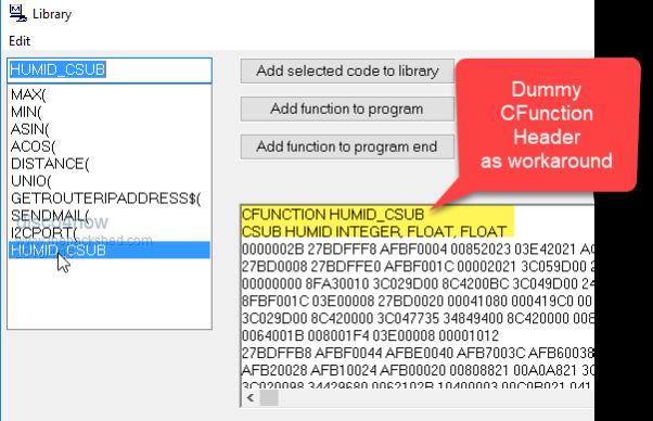

disco4now
Joined: 18/12/2014
Posts: 1157
Posted: 09:48pm 15 Apr 2018
Hi Jim,
A small one if you are doing any update in future.
The library does not index CSUBs that it contains. I think they add in OK, just not listed. My workaround is a dummy CFUNCTION header.
Its handy to have HUMID etc now they are CSUBs.
Gerry

Posts: 6621
Posted: 11:13pm 15 Apr 2018
Gerry
I will have a look at it but it will be a few weeks before I can put out any opdates.
