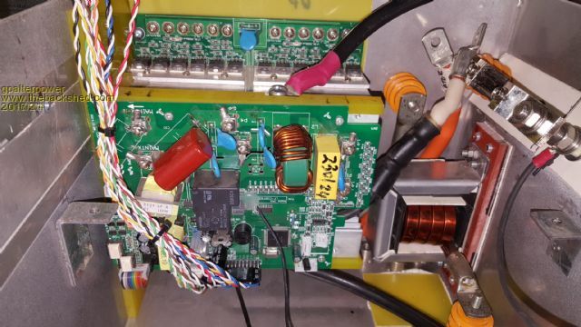

The powerjack inverter is a H bridge design. It is what was used as a starting point/template for all of this DIY tinkering.

I have included a pic of the PJ boards. I just wanted to confirm before doing any changes to my system. If its not up to scratch then Im sure I could use the original 3kw power star inverter as I know for sure they are also work as a battery charger. Presently its just sitting there collecting dust

Yes that is the right type Marcus.

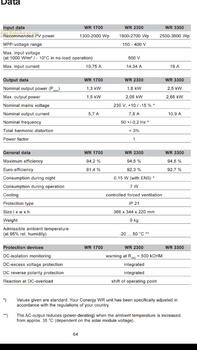

See if you can find out the specs for your GTI Marcus?
it is handy to know what the high grid voltage disconnect is.
and the reconnect voltage and if there is a wait time set
for example it might be disconnect @ 270V wait 3 minutes reconnect if below 255V, that sort of thing. Then you have a rough idea of what to expect
some inverters can be tweaked a little using an installers code, some just have fixed settings for each country. I spent a couple of years hoping to crack this and customize the settings for a couple of brands. the conclusion I come to is that it doesn't matter how smart we think we are and what we can do using the original equipment it is usually a waste of effort to reverse engineer code when we can simply over-ride it externally.
edit sorry, your last post has slipped in before mine, looks like it works, I am surprised the battery voltage didnt go higher than that. You should be able to measure the AC and work out the gti settings.
cycling every minute will fritz the relay eventually, looks like you need that external control.

A check with Mr Google and soon found out about my GTI. Mines the WR2300. This is all that I could find in the 85 page online catalogue about input/output specs.
Not sure if this page tells all. Seems the voltages are set. There is more info about fault codes which is important too plus more pages of reading bout instillation. Im not going to even think about trying to tweek it in any way...I aint that smart and would just end up stuffing things up! It is working right now, but just noticed that the battery voltage just climbed above 28.5. Thats not over the top but I dont normally see it there.
This is really a test to see if it works or not.... and it does, which is great. So it has satisfied my curiosity for now with the help of you guys, and I do appreciate that. Until I work a few things out, I can just turn it on first thing in the morning, off around 10am , then back on in the arvo around 4pm. That will give me more flexability of power for now until additional battery storage/ power diversions can be organised.
Just noticed 29.3v... just shut it down.
