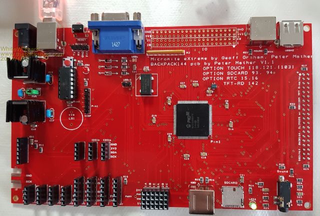

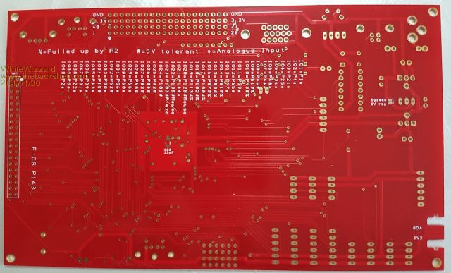

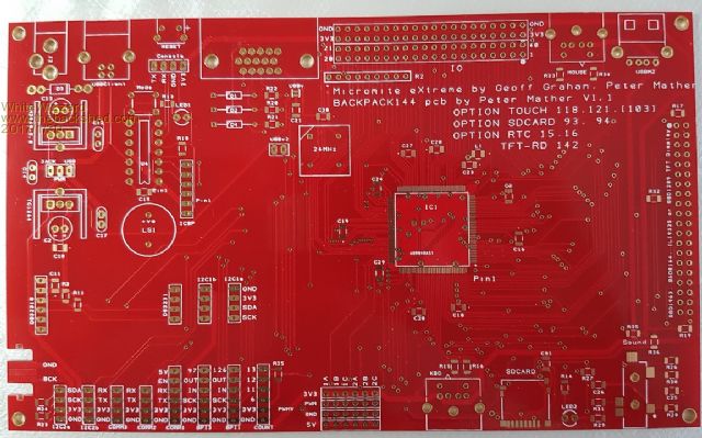

First pictures of MMX144 PCB
PCB is finished in Gold (makes for easier soldering; as well as looking very nice!) with a red solder mask.
Underside shows the 40-way GPIO pinout to the MMX (and the solitary 22uF capacitor!!)
A couple of silkscreen teething errors have already been fixed by Peter (Thanks Peter )
More photos top follow shortly . . . .

The first one has just been assembled this morning . . . (still need to tidy some SMD joints on all the decoupling caps)
I ordered the incorrect onboard piezo so it is unpopulated in the photo
Notice the 'HeartBeat' LED on the lower edge (honestly - it is flashing which means the module is 'alive')
Now to connect a console/PC . . .

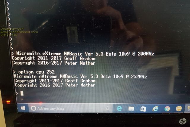

As with all Geoff's 'inventions' (and Peter's code), it just works first time . . . .
.... running at 252MHz

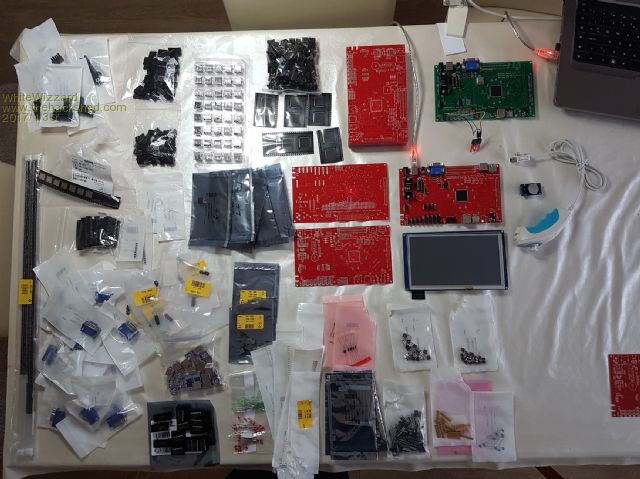

The assembled green PCB in the picture is the original prototype (no mouse connector, no Nunchuck connector, no buzzer)
I still have to test the completed PCB (VGA, SSD, SD, I/Os, RTC . . . ).This will take some time so I will not ship any pre-orders just yet. I will keep you all updated on this thread with progress . . . .

Schematic to be posted on website when I get a moment. Size is the exact size of a SSD 7" which equates to: 181mm x 108mm (lots of gold )
It could have been a bit smaller - but designed to be a perfect fit for a 7". This allows for ALL connectors to be onboard (i.e. PS2 Keyboard, PS2 Mouse, VGA, SD, 3.5mm stereo socket, Nunchuck, 40-way TFT, 40 way GPIO, all other I/Os grouped together nicely (PWM, COM, SPI, I2C), RTC, USB-to-UART . . . . . ).
