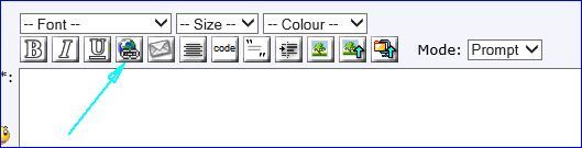

Dunno if this is gonna work, but thought I'd try pasting in something from my "Micromite" page to see how to get things like www.gpss.co.uk to appear as a hot link. Big Mick did it early on. Here's a try at pasting in >>>>>>>>>

You could try the editor toolbar.

Thanks BodD let me try that 4th button ....
www.gpss.co.uk
... will try it.
But before, I'll try doing a cntrl-V instead of the link....
link to video image
Now I'll see if it works. Thanks BobD.
Robin
p.s. Great - the important hyper link works.
May try an image next.Robin's mug shot
Yep, and I expect a video would work.
I wonder how Big Mick embedded that image into his posting - that of the French boat on the first page ?
Duh ! :-) Button further along. Thanks BobD :-)

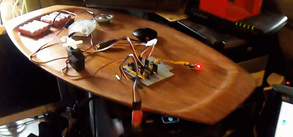

Almost there, and if I've not left home, you will know, and I will hear your email come in, including if it originates from this Forum thread. I just updated my MicrMite page with the info further down ....
Newsflash on Thursday 16th: I'm up early, and hope to have Snoopy's new MicroMite Autopilot software working well enough to do a "tea tray test", with it given spoken GPS guidance, and servo rudder control, from my front door, to the corner of my drive, up to that lampost, then back to our house. I may even have it "steer" me over to my friend Eric this afternoon, when I go over for tea and cake. Why so optimistic ? Click on that animated picture on the right - my GPS Software from the early 1990s, was written in practically the same language as MMBASIC. That later Pocket PC, from ten years ago, included Snoopy's first Autopilot !
But first I have to take a cup of tea up to my wife June, or she won't get up to go to work ;-)
More detail later today, but in brief: Roy's tea tray system is running with text to speech, servo, and the GPS is ALMOST there. I'm getting occasional sentences and there are two solution that might take me minutes rather than hours:
1) Hardware: I've swapped that GPS to a BR-355 S2, after I saw it was the earlier version, with LOTS of other NMEA sentences. I put a Futaba lead onto the BR355-S2 so it plugs onto Roy's Board - and they work together ! Sadly, I see that I need to apply a firmware patch, and set up the GPS so that it ONLY outputs $GPRMC sentences. That makes an enormous reduction in the work that any Picaxe or MicroMite must do. Sad ? Because I need to solder up an adapter cable to connect the GPS to my PC :-(
1400: NOW DONE, WITH BR-355 BACK ON ROY'S BOARD, GETTING $GPRMC SENTENCES.
I NEED THAT MID$ BELOW OR ALTERNATIVE. (BR355 setup is already documented in BlogX).
2) Software. I'm using statements like Roy has, such as a loop using the Function INPUT$(1,1) to read individual characters, and also like INPUT$(100,1). But there maybe alternative serial input statements in MMBASIC. e.g. reading a list of strings seperated by commas ? The simplest solution is if MMBASIC has a string statement like the old VB MID$
e.g. type$ = MID$ ( BUF$, 2, 5 ) 'to get "GPRMC" from a NMEA GPS message in BUF$ like $GPRMC,etc,etc
If I'm still working on it, my car with that tracker link above, will still be on my drive, and I will hear your emails come in :-)
Back to MMEDIT: just need that MID$ above if I'm to take it on the road while the sun is out :-)
1415: NO WORRIES: MID$ FOUND IN MANUAL. WILL TIDY THIS PAGE UP TONIGHT. MAY BE AFTER TEA TRAY TEST(S) :-)

WE DID OUR FIRST TEA TRAY TEST TODAY. SUCCESS ! CHECK OUT [WWW]. MORE TOMORROW :-)

Hi Guys. There was some progress today, with a first tea tray test. My wife wanted a trip out to Wisley Gardens, and it ended up being the first MicroMite Tea Tray Test. Check out [www] which is www.gpss.co.uk/micromit.htm I will try and add one of the video frames here.
