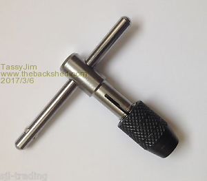

For small taps, I prefer to use a t-bar holder. I find it is easier to hold true.

I got P&N 3mm starting taps from my local The Toolshed. I also got a ratcheting T-Bar handle from Tradezone for about NZ$30.00 Both companies have branches in Dunedin. Finding a good handle for small taps is not easy, The Tradezone T-bar was about NZ $40.00 . I find T-Bar handles make it relatively simple to cut a straight thread and they are harder to apply excessive force to the tap with the shorter handle, ie you get better feedback when the tap starts to bind

If you look at the top of a tap there is a small hole or a point. This is used to center it.
When i mentioned a drill press i meant to say to use it as a guide!
Have a look at this video as it explains it very well.

A few weeks ago I did a job for a mate building his still and drilled and tapped 24 M3 threads in copper. Drilled the holes in my mill to a 65mm pcd and just used a larger drill to chamfer each end of the holes. Chamferring the hole gives the tap a good chance to start rather than no chamfer on the hole. I do have about hald a dozen of those tee wrenchs form a very small one for doing BA taps all the way upto large ones for doing 1/2".
Now with a tee wrench it should have a centre hole at the end of the shaft and that can be used as a centering aid. For using in a drill press just get a tap or such that has a tapered point and put that in the chuck. With the work clampd to the drill press bed put the tap in the hole then apply very light pressure so the tap is sitting square to the hole. Now with one hand on the drill press arm and the other turn the tee wrench while keeping light pressure will ensure a square tapped hole is achieved.
