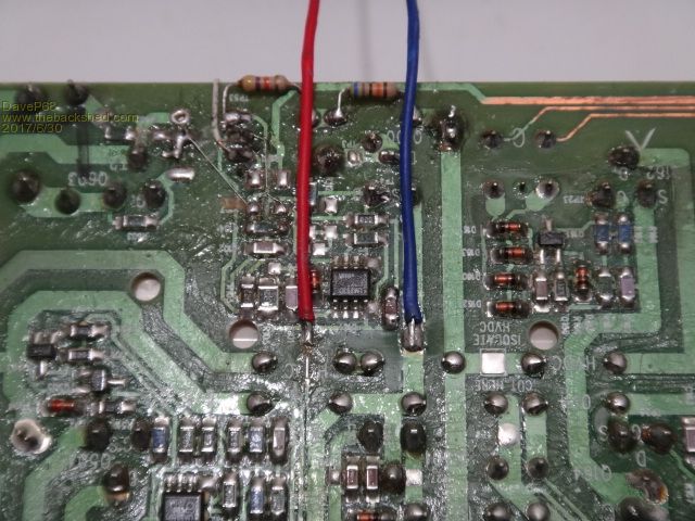

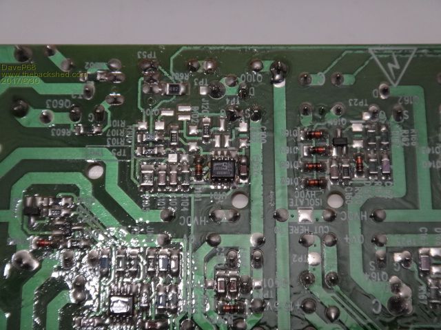

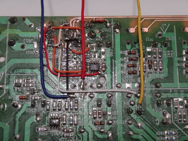

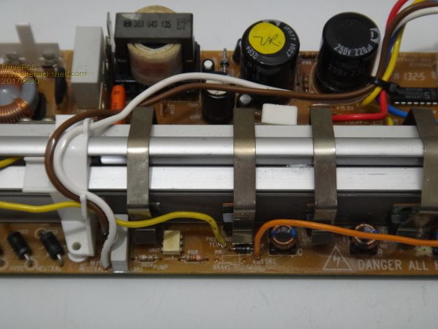

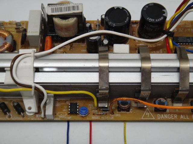

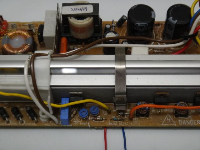

Attached are some photos of 2 modified F&P motor control modules set up for constant current control and constant voltage control with adjustable settings. The original circuit was designed for fixed constant voltage control of 400 VDC.
They all use an IRGBC20S IGBT as the switch device with a 20 ohm 1 kW peak rated resistor which sits in the top of the heat sink as the dump load.
Here is the first modified board for current control, top and bottom.
Note the LM358 op amp bottom center left. This has been added to the board in place of an optocoupler that was removed as not used in the brake function. The current sense resistor is 0.22 ohms 5 W located in the middle of the board above the heat sink, below the left hand black 250 VDC capacitor. The red & blue wires are for 12 VDC supply. The feed DC into the board to be controlled is via diode kathode bottom left and the yellow wire.
Next is a board modified for constant voltage control over a 40 - 460 VDC range.
These last 2 photos are of an original non modified F&P board.
Note the optocoupler is still in place in this non modified board.
In their present configuration they're not much use in a real world application. Have put them into use recently to prove that the concept of dynamic braking can be done with simple circuitry without the need of complex microprocessor control.
When I get time will scan a copy of the actual circuit diagram if it's of anyone who would like to try to build their own.Edited by DaveP68 2017-07-01

Thats really interesting Dave.
A three phase induction motor also behaves as a brake if you flow a steady dc current through two of the three star windings connected in series.
A schematic of what you have there would be very helpful.

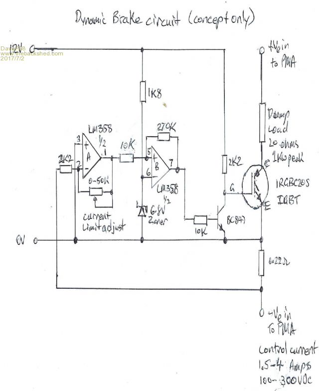

Once again thanks for taking interest in a topic not discussed that much, but could yield some good results in time if set up properly.
Here is a scanned copy of the basic circuit as requested.
The current control has about about a 20 % drift in this set up. Setting the current to 2 amps at 60 VDC it goes up to 2.4 amps when at 200 VDC. It's good enough to prove that the concept works in principle.
Will make some improvements when time permits> Having a business to run on week days, children to keep occupied on weekends burns up most of that.
The resistors and IGBT switching devices can be paralleled to provide more current capability with lower voltage operating range.

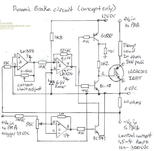

This dynamic brake circuit has been modified for 24 VDC operation but requires the IGBT switching device and dump load resistor to be in parallel multiples.
The trip voltage is set for say 29 VDC (adjustable) and the load resistors can be reduced to 5 ohms. You would need a minimum of 5x IGBT switches and 5x 5 ohm dump load resistors set up in parallel. All feed from the same drive transistor to each IGBT gate input.
This again is "Concept Only" and does not reflect an actual operational circuit!
The actual voltage trigger circuit would be some logic to trip then keep the clamp circuit on for the desired braking period. This could be minutes to say a few hours to said high winds have passed. Could also have an anemometer input to release the brake once winds have dropped to an operation level after a set period.
What are your thoughts?

Thanks for your help in adding to your original circuit diagram even though its still in the concept stage. I'm assuming there could still be a few bugs to iron out. Are you planning on testing one soon?
I like your anemometer idea, but would it be possible to somehow utilise the f&p speed sensor to just slow the mill down and not come to a complete stop. More like squeezing on the brakes to a useable speed. This way it could still charge, but not be out of control. Maybe too complicated

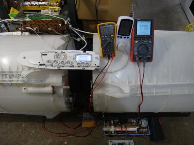

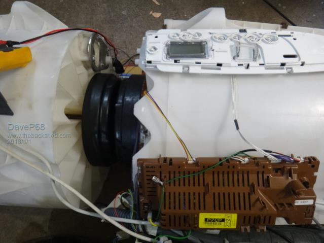

Haven't been on here for a while, so thought I'd update this topic relating to the use of this dynamic brake control circuit.
Modified it to be used as a fully programmable dynamometer (enhanced VFD) to measure the efficiency of F&P stators. Having lots spare motor control modules from scrapped washing machines thought I'd re-purpose one to used as a fancy VFD.
Now able to test F&P stators in different configurations or applications such as MPPT (Wind mode), how linear power curve is vs RPM constant load or as a voltage clamp to simulate battery charging.
It uses 2x F&P stators connected back to back. Stator #1 is the drive motor in it's factory stock standard star mode. The second stator can easily removed and changed for another set up in a different configuration star vs delta wired 1x 12c or 2x 6c etc.
Currently has an operating range of 23 to 250 RPM (most testing is in 92 - 250 RPM range) maximum input drive power is 470 W. Hope to modify the F&P motor controller to widen the operating range from 23 - 650 RPM with 3x the input drive capability up to 1400 W. The RPM measurement is done by the motor controller and shows on the display module. This can only be viewed in a special diagnostic mode hidden from your washing machine user.
The dynamometer function came about by adding a fully programmable board that interfaces into the reference point of the PWM circuit comparator to make it's own adjustments. This allows full control over current 0.05 to 6 Amps DC and/or voltage from 30 to 500 VDC.
Just a simple re programme to change the test mode. Won't be publishing this new circuit at this stage. Will take to much effort with most of it on bread boards and in my head not on paper.
A photo of the complete setup running at 201 W continuous output at 216 RPM (note the glowing resistor in the blue module).
Close up photo of the motor controller that makes it all happen.

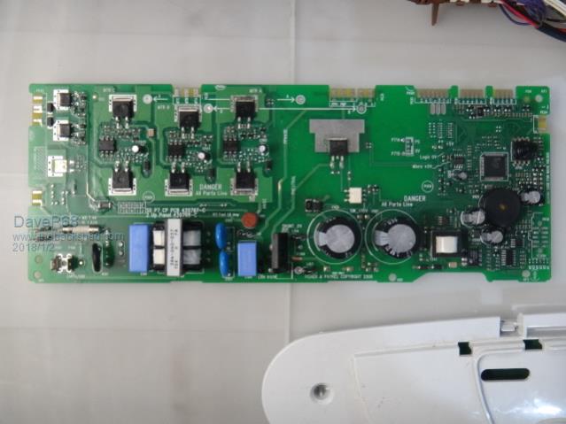

Yes that very useful function in the display is not in the technical manual, it requires special know how to get to.
You can't just set up a system like this and hit the start button. It requires a deep understand that only the F&P design engineers have. Have a friend who designed the very same circuit board I'm using in my test rig. It's sometimes not what you know it's who you know
Here's a photo of a board covers removed for those that and are interested.
David

Use a 3 phase brush less dc motor controller board. Thing is the board shown has a 320 VDC bus to drive the star motor in it's factory standard configuration.
A bus voltage that high is "Dangerous to play with" if you don't have my back ground/knowledge of F&P smart drive product. There is no transformer on that board to provide isolation!
By one of these off Ebay for $39.99 USD + Shipping
48V 1500W Electric Bicycle E-bike Scooter Brushless DC Motor Speed Controller
Then rewire the stator to 6x 2c and you be able to replicate what I've.
No fancy tricks here making something like this. The hard part is doing all the math with the data and turning it into graphs etc
