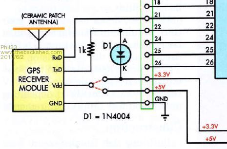

So what's the disadvantage of doing the hardware solution like Geoff uses in most of his GPS projects? It was what I had in mind for all my HC-12's, which I'd rather run on 5V, so there's less load on the 3.3V supply.

Do you mean to have GPS Vdd at 5V?
What is the max voltage drop A-K when TxD is high i.e. what is the max volts on pin 22?
(And is it within PIC32 spec?)
I take it that the 1k is intended to provide a current limit? But as there are apparently no clamping diodes in the PIC32 is the 1k guaranteed to work?

@Phil23
In your schematic, the 1N4004 diode (200V/1A rectifier diode) is an overkill, and being a Silicium diode, it will only clamp at 0.7V or so above Vdd, which is beyond specifications for a PIC 3.3V inputs.
I use small BAT85 Schottky diodes for such a clamping (will clamp at around 0.3V above Vdd, i.e. within specs).
