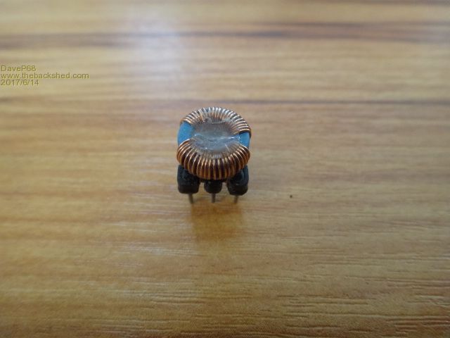

Isolated gate drive can be achieved using small high frequency transformers driven by low power CMOS gates. The output of which can be rectified to provide full gate drive voltage to the MOSFET's. Have them by the hundreds as that was the technique used by F&P to drive the high side MOSFET's on the motor control module boards.
Here is a photo of one.
The current drawn at very low wind speeds is of no concern if it's being feed into a battery system. This is due to the driving torque of the shaft providing a natural limit on this anyway. This is done by getting the cut in speed voltage correct in the first place and will only allow the current to flow proportional to the power provided from the shaft.

Posted: 10:45pm 14 Jun 2017
Those little transformers look to me like a standard common mode choke.
If you can measure the inductance, it would probably be fairly easy to find a direct equivalent.

Posted: 08:45pm 15 Jun 2017
I'll have to get back to you on that as the 'common mode choke' as you put it that I've got in big numbers just work from my perspective. Not much incentive for me to find out it's electrical characteristics.
Will let you know the results though when I get the switching circuit that you proposed up and running.Edited by DaveP68 2017-06-17
Posted: 08:59pm 15 Jun 2017
O/k fine, its just that you said they were now hard to find.
If you already have quite a few salvaged from old circuit boards, then no problem.
It makes sense for F&P to have used something like that as they are cheap and pretty readily available.
They are made and sold to be used as common mode chokes, but they can also be used as a 1:1 high frequency transformer with pretty good voltage isolation.

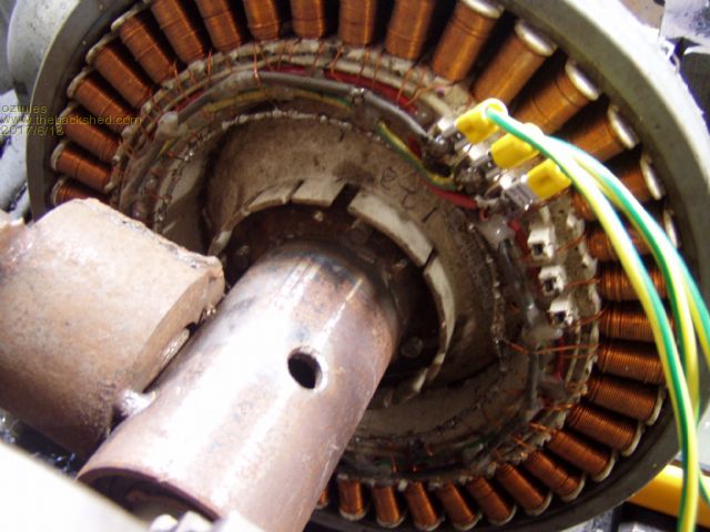

Davep68, I tried to play with my f&p, but i had wired it for low voltage high torque pump application on a mono pump... which works very well oddly enough..... anyway, I decided to pull it off and put it in the lathe, expecting maybe 15 amps or so, and at fairly low rpm... maybe 300 perhaps.
I don't know what stator it is, and have not even bothered to count the poles after the modifications some time back... memory is poor and pole count matters not any more, but you will probably want to know what it is... the pic follows.
I fired it up into some 220 amp 6v batteries, and this is what happened.
here is the stator with feeble wiring.
It needed over 500 rpm to get to 20 amps, and made it to 40 amps or more...on the 750 setting...... then the belts slipped.... the pic caught it at around 38amps.
So it was clear the driving device would not go much further.
I slipped a phase out to get an idea of what may happen when i connected the star point.... it went from 20 amps to 25, I was pulling up near 1000 rpm, belts were not happy, so I can say that in single phase , when you add the star point diodes as well, there is a marked increase, but i will need to do something better with the driver before i can discount the three phase hook up. It seems to be getting current limited after 750rpm, so the delta would not kick in until well over 1000rpm I suspect.
Anyway thats as far as I got today, and proved nothing, so at this stage i can't say the star delta diode system works at all ... never mind well, but the theory seems good so it needs better power inputs.
Very surprised at the 40 amps... didn't expect that much , and it would appear that a 5hp IC engine coupled to it would make a nice cheap little 2kw 48v charger ... even in just star.
I noticed the iron losses are very small too... another good thing.
EDIT..... on reflection, I should have tried it on 6v....dammit, i've put it away for the day .... maybe tomorrow...
.........oztules
Edited by oztules 2017-06-19

Hi oztules
The stator looks like an 80s 14x 1p star. Did you feed it into 2x 6 V batteries in series? That would make the battery terminal volts something around 14-15 VDC depending on how charged the batteries were.
The optimum current from that set up is 28.28 Amps at what ever volts/RPM level you want to run at. The maximum current is 40 Apms which is 1.414 x that optimum current for 80s 14x 1p star.
Interesting result removing 1 phase and noting a jump from 20 to 25 amps. RPM was very high though.
These stators are very predictable once you get to know them in their star/delta nodes.
oztules
Joined: 26/07/2007
Posts: 1686
Posted: 11:24am 18 Jun 2017

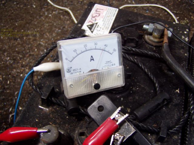

oztules
Joined: 26/07/2007
Posts: 1686
Posted: 01:06pm 18 Jun 2017
It's official.... don't know what I am talking about.
The best I can do is 45 amps on the dot. As I was only interested in the current, a short circuit was sufficient to test this setup. The leads are skinny, so it was nowhere near a real short I guess.
Result is NO DISCERNIBLE CHANGE with the extra diodes in place it was 45 amps versus 45 amps.. nothing... nix..
I can't see why this is the case... but it is.. Dave was right.
Still amused that 45amps is possible before full back mmf cancels the driving field.
At higher rpm it will also get inductive reactance due to the high frequency... but it takes very little rpm to get 45 amps at short circuit, so at least I can say the the frequency induced reactance is not why current limiting is occurring, but in fact back mmf is responsible for the most part at these low frequencies. Herbnz was right, flux was less right.... thats it for the synchronous impedance anyway.
I can see a generator being built soon using the 80s stator. 40 amps is plenty for a little petrol motor.

Hi oztules
The optimum current refers to the most efficient power extraction at that RPM level. So in my example that turned out to be 1575 W at 1870 RPM with other readings of 57.4 VDC at 27.44 Apms. The current reading was over an approximated shunt, close but not as accurate so reading could have been as much as an amp too low.
Your maximum of 45 Amps is the limit again my one didn't quite get that high but I would have only been about 3 amps lower. I also didn't test my 80s 14x 1p at a very high RPM to reach 40 plus amps so my 1.414 times was just a projection. I your case you got about 1.5 times optimum current.
Some rotor caps can have less magnetism especially if there was a motor short on at the time of the washing machine failing which can generate an opposing field.
Will need to repeat my test to confirm your peak reading of 45 Amps with a different rotor cap. This time will do the new test at 24 VDC at around the same RPM level to check what my maximum current will be.
