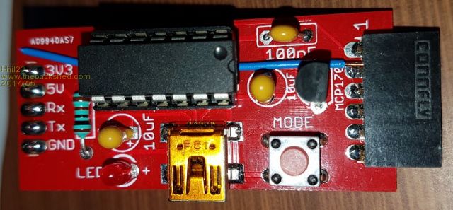

Might do this simple mod to get power to Pin 2 of the ICSP.
Just swap the 5 pin header on Con 2 for a 6 pin, after drilling a single hole.
Then a bit of Cat5 can be slipped under the chip.
If power from the Microbridge is desired for flashing, I can just fit a jumper between 3.3 & the additional pin on Con 2 to supply the 3.3V to the ICSP connector.
Might be a simple enough change to incorporate on future orders for this PCB.

3v3 can be picked up on one of the pins of the MCP1700 regulator. i would strongly suggest using a diode to feed the 3v3 from the regulator to pin 2 of the ICSP connector, unless someone can put forward a good reason not to?

it is no problem, provided folks are aware that they need to do it. phil23 wasn't aware of it, and got stuck. the pickit2/3 has the same problem, in that by default the Vcc output is disabled, and even when enabled it often does not succeed in powering the target device.
the original arduino NANO based design does supply 3v3, and so it would be nice to operate in a similar manner to be compatible. pic32prog goes to the trouble of specifically sending a command to turn on the 3v3 supply before programming, and another to turn 3v3 off after programming and verification has been completed. this was done to ensure that the target device would not run uploaded code while the programmer was still attached.
i guess there is no 'perfect' answer that will suit everyone, all one can do is try to find one that creates the least number of negative user experiences.

Regarding the 'intermittent button response' issue:
Rob originally suggested adding a 10K pull-up on the button input (i.e. between PIC pins 1 & 4). This had zero affect in resolving things.
HOWEVER, he then suggested a 10K pull-up on the RxD pin (i.e. between Pins 1 & 5) and this has FIXED it. As previously mentioned, when the RxD pin was left 'floating', the button response is very hit-and-miss. Now with a 10K pull-up on RxD pin it works as expected (I have removed the Pin4 pull-up by the way)
ROB: can the RxD pin be pulled-up in software please? This would help avoid needing to modify the MB units I am shipping out!

  Quote  ROB: can the RxD pin be pulled-up in software please? This would help avoid needing to modify the MB units I am shipping out!
No: the chip doesn't support it on the RX pin

I never had problems with the button on my version when the TX and RX pins are left floating. They are setup as a UART from the start so that should take care of the pins.
This would suggest it is solvable in software.
Maybe the RX pins picks up some interference which might influence the debouncing of the button.Edited by MicroBlocks 2017-07-06
Posts: 2556
Posted: 03:11am 05 Jul 2017
  MicroBlocks said  Maybe the RX pins picks up some interference which might influence the debouncing of the button
i'm inclined to agree. but then it is perhaps not fair to expect the 1455's hardware UART to be able to handle a floating RxD pin gracefully. a good portion of the noise would translate to framing errors (a brief pulse starting a receive sequence that has an incorrect start or stop bit), and in the case of bad start bits these could be occuring at a rate far exceeding the normal character rate - such a framing error could be detected by the UART within half a bit.
given that an internal pullup can not be configured, an external pullup on TxD would be my recommendation. perhaps try 47k and see if that works - though 10k is also fine.
