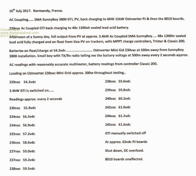

Okay Oztules & Madness, finally got some test data on the AC voltage rise set against battery voltage rise when a GTI is backcharging
Note, the batts were full and on float, no diversion or dump loads.
Note, the 8010 boards had a similar readings, but I stopped at just before 62vdc.
Edited by Clockmanfr 2017-07-17

Well that looks like mountains of room to play with... looks like I just need more sun to push the thing harder..... hopefully get some sun today, and will try a little tranny out.
It seems to gyrate around a few ( up to 5 maybe) hundredths of a volt in it's fuzzy logic of up down, and thats dividing from 59v. I'd still be very happy with 60v if I was ac sensing.
So it looks like each GTI inverter could have this built in.

Hmm, Oztules gets no ac voltage rise on his 8010 boards. hmm
Mine were just as similar as the PJ boards, hmm. I will delve deeper, but that means if there are differences with the OzInverter Mk1,2,3,4,5 and 6, then the AC side is not a viable option.
I was trying to get a simple robust solution to shut the AC side down of the GTI, its normal operating parameters on most GTI's. Yes a Bang Bang as oztules calls it.

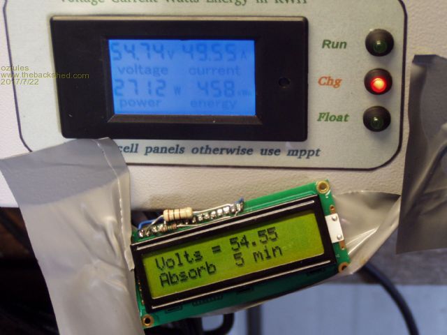

Today it ran very well, and holds the voltage within a few hundredths of a volt when there is no pertubations on the line... ie it went up to 59.0 +-.05v then held there for 15 mins ( how I set it), then held steady at 57v +-.05v.for hour after hour.
I was pretty impressed how these little nano's can discern the voltage from such a small input signal.... which makes your AC signal big enough to work on I reckon. Changing the definition of the increment, and the timing of the look up, makes a difference yes, but not as much as I expected. It can be pretty clunky, and easily achieve the same thing I think.

Posted: 03:27am 19 Jul 2017
lcd support added.
Will test it out on the live system tomorrow.

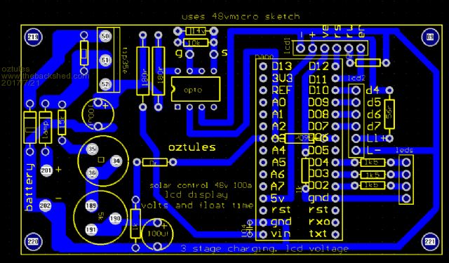

ok clockman, things have changed.
It is now a fully digital affair, The LCD readout has voltage, and mins of each stage in real time... the micro also has outputs for three leds if you don't want the screen .... just to tell you where in the charge cycle you are.
The board looks like this now, and I will get some made, as pcbway is doing 10 boards for 5 dollars..... i cant make them in the bath for that.
The code for it is this at the moment.
Will be tested fully today, but appears to pass the smell test.

#include <LiquidCrystal.h>
// initialize the library with the numbers of the interface pins
LiquidCrystal lcd(12, 11, 10, 9, 8, 7); //10-7 data.12,11 control
int fullTime=0;
int bulkTime=0;
int ledPin = 6; // fet gate connected to this pine via totem
int stage1pin =2;
int stage2pin =3; //three pins for stage leds
int stage3pin =4;
int analogPin = 3; // divided voltage from battery or transformer
int val = 0; // value of voltage query
int count=0;
int pulseVal = 0; // initilise the pulse width to zero of 255.... won't help really as the thing will run for three minutes before kick off
long floaTime=0; // initialise the time to zero for the absorb
int floatVolts = 969; // compared to the figure of the bulk and absorb...
int bulkCharge = 1000; // figured that half way ( 1000 ) would do as the set point for absorb voltage
int absorbCharge =1000; // voltage equivelent for the absorb voltage.... same as bulk.... funny about that.
int startAllOverAgain = 862; // probably in the 49v range
long timedOut = 107000; // time delay and step rate will change this...107000=2hrs
int increment = 10;
int weAreHereNow=0;
void setup() // this is where the story starts...
pinMode(ledPin, OUTPUT); // sets the pin 6 as an output for the fet drive
pinMode(stage1pin, OUTPUT); //sets pin as output for the stage leds
pinMode(stage2pin, OUTPUT);
pinMode(stage3pin, OUTPUT);
Serial.begin(9600); // for the detective work
void loop() // and this is where the story really starts
Serial.print("pulseVal =" );
Serial.print(pulseVal);
Serial.print(" read value ="); //show and tell time
Serial.print(val);
Serial.print(" time value =");
Serial.print(floaTime);
Serial.print(" weAreHereNow =" );
Serial.println (weAreHereNow);
delay(10); // use this to speed things up and down.... responsible for the timing number calculation
//===========show the current volts with slow up routine called count.==========
if (count==5)
if (weAreHereNow==0)
lcd.setCursor(0,1);
lcd.print("BulkChg");
lcd.setCursor (8,1);
lcd.print(bulkTime/860); // makes it about a minute update at 860.. ish
lcd.print(" min");
if (weAreHereNow==1)
lcd.setCursor(0,1);
lcd.print("Absorb ");
lcd.print(floaTime/860); // makes it about a minute update at 860.. ish
lcd.print(" min ");
if (weAreHereNow==2)
lcd.setCursor(0,1);
lcd.print("Float ");
lcd.print(fullTime/860); // makes it about a minute update at 860.. ish
lcd.print(" min ");
lcd.setCursor(0, 0);
lcd.print("Volts = "); // print the volts out
lcd.setCursor (8,0); // the if count is to slow the screen update to the value of if count=x
lcd.print (val/16.94);
count=0;
count=(count+1); // increment the counter for printing to stop wobble
//====================this section just for song and dance and twinkly lights
digitalWrite (stage1pin,1); //digital pin will light up for the bulk charge bit
else
digitalWrite (stage1pin,0);
if (weAreHereNow==1) // this lights up digital to signal stage 2 the absorb cycle
digitalWrite (stage2pin,1); // this is all to light up leds to see where we are in the cycle
else
digitalWrite (stage2pin,0);
digitalWrite (stage3pin,1); //this lights up stage 3.. the float cycle
else
digitalWrite (stage3pin,0); // remember if we drop below about 50v it will reset everything, the leds will show this too.
val = analogRead(analogPin); // read the input pin
if (val< bulkCharge)
pulseVal=pulseVal + increment; // was not up to bulkCharge, then increase pulse width incrementally
if (val>=bulkCharge && weAreHereNow==0) // now bulkCharge is here, change the weAreHereNow to 1 as a flag
weAreHereNow=1;
if (val>bulkCharge)
pulseVal=pulseVal-increment;
if ( pulseVal>=255)
pulseVal=255;
if ( pulseVal<=0)
pulseVal=0;
analogWrite (ledPin,pulseVal);
if (weAreHereNow==0) //if weAreHereNow is one , then count each cycle from now on until it no longer equals 1
bulkTime=bulkTime+1;
if (weAreHereNow==1) //if weAreHereNow is one , then count each cycle from now on until it no longer equals 1
floaTime=floaTime+1;
bulkCharge=absorbCharge;
if (weAreHereNow==2) //if weAreHereNow is two , then count each cycle from now on
fullTime=fullTime+1;
if (floaTime>=timedOut) // once we reach timedOut, we have finished our absorb sequence, change status flag weAreHereNow to 2, and change the voltage now to float value
weAreHereNow=2;
bulkCharge = floatVolts;
if (val<startAllOverAgain) // panic routine when voltage drops back to 48 volts or so.
weAreHereNow=0;
floaTime=0;
//that all folks
So it is a very simple program, but poorly written as it seems too long to do so little.
Anyway, it prints the voltage = xxx on the top line, and the stage and number of minutes it has been operating in that stage... nice to see where we are in the charge cycle, ie bulk plus time..... then absorb plus time in absorb, and then float and float time.
It is set for 59v bulk, 59v absorb, 57v float at the moment.
......oztulesEdited by oztules 2017-07-22

Here is what it looks like cobbled into/onto and outside of the DC DC solar controller box.
So it can run GTI or 60v or whatever solar panel to battery controller box.. like this one is.
Yes there is a discrepancy of about .2v with the two voltages, but thats just changing a single line in the program.
The lights are now integrated with the computer, and run now means bulk, chg now means absorb, and float will mean float... need to make another label.
The calibration pots on the board also affect the voltage algorithm.... pesky, but thats life... the calibration figure in the micro, is used on the voltage from the divider on the board.... so a change in one necessitates a change in the other.
.....oztules
