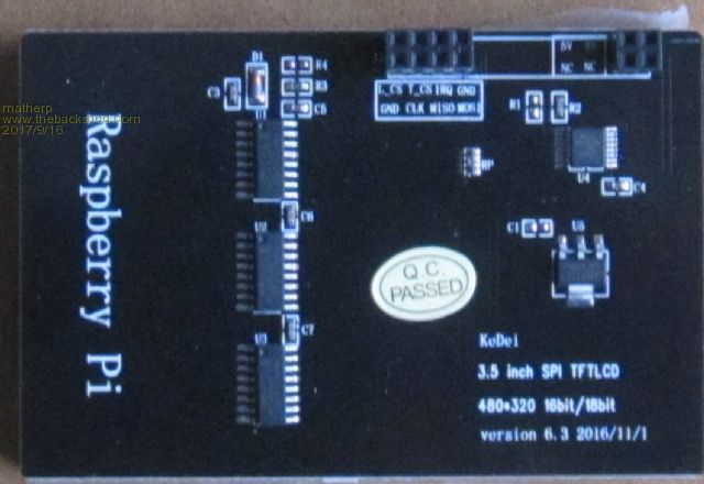

would it be possible to make a driver for my 3.5 inch display? That should have an ILI9486 chip
It runs at my RPi3 (with the ILI9481 driver) but not on the zero w
LINK
if you need it physically I will send you the money by paypal
best regards Ron

  Quote  would it be possible to make a driver for my 3.5 inch display? That should have an ILI9486 chip
Ronn, you can try the attached which may work based on three assumptions
1: your board is actually an ILI9486 - there are lots of different drivers on these boards all of which have different initialisation
2: The initialisation sequence I found online is correct
3: I implemented it properly
USE OPTION LCDPANEL ILI9486..... to configure
Let me know - no change of version number until I know it works

hi Peter sorry i have to report :it does not work with the Zero W- the same effect as i use the ili9481 driver
I wonder why it works at RPi3.... Edited by RonnS 2017-09-05

If I understand your previous posts correctly, on the Pi 3 you are using a Raspbian image that came with the screen - is this correct?
If so then it is properly initialising the screen and the subsequent mmbasic initialisation is not doing any harm. The cursor positioning and pixel upload for all these screen controller variants is the same - the issue is correctly initialising the specific controller.
I've ordered one of these which I will get working once I have it. This may or may not be the same controller as yours but there is a chance.
Have you got any screens working on the Pi-Zero? Which Raspbian variant are you running on it?

no ....i use a standart Raspian Image.I want only to use this displays with PiCromite Basic by using your drivers they are implemented
the 3.5 and the 4.0 inch Displays are working with the standart Raspian Image that you have too ..and a Raspi3.. by using PiCromite Basic with your ILI9681 driver
you have shown the way with your waveshare 4 inch display did you remember?
but the 3.5 inch display dont work with the Raspi Zero W standart rasbian image under Picromite Basic
i increased the zero w clockspeed up to 900 mhz so i got a full screen instead a half screen of different wild patterns by running GUI TEST LCDPANEL
with ILI9481 driver and the new ILI9486 driver no difference
next i could test the behaviour of both displays with the ili9486 driver at my Rasberry Pi 3

at both displays i only see a 3/4 of the screen 1/4 is a grey rectangle
GUI TEST LCDPANEL works in the visible part
to remember: the 4 inch display works with both, the Raspi3 and the ZeroW -
driver is ILI9481
hope that helps

Please try this hack version on the PI-zero as an experiment, both drivers
2017-09-05_093501_mmbasic.zip
No functional change but I've slowed down the SPI for the displays.
Note, you should always unplug and replug the displays between tests as some of the config seems to survive the hard reset and can confuse results

Hi Peter , first i try it with the ILI9481 driver and it works !
the 3.5 inch Display has a brilliant brightness and contrast
more tests i can make today in the evening or tomorrow morning.. . have to work :)

both displays ( the 4 inch and the 3.5 inch )are working with the ILI9481 driver and a SPIspeed up to 16 000 000
the 4 inch display works much better with this SPIspeed
as an example : the GUI LED is really off when it's off, not just half
and
the "Palette" display more than 8 colours now :) , its ok

it was a wrong information i've got from the salesman
this display is a ILI9481

Don't buy this display as I won't be supporting it on either the MMX or Pi-cromite.
Note the split connector. When you examine it closely you can see there is only one chip select connection for the display itself + the SPI connections. This is because the display is set for 3-wire serial mode. In this mode the data/command mode is set by adding a bit to the front of each byte - i.e. a 9-bit transfer. Neither the MMX nor Pi can support this in hardware so the I/F would have to be bit-banged. The vendor KeDei does provide a Pi image to support the screen but, unsurprisingly, it runs like a dead pig.
Oh well £10 wasted but I'll harvest the various chips for possible future useEdited by matherp 2017-09-17
