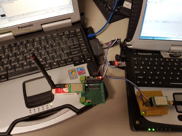

I received the LoRa modules yesterday and have come to a brick wall in trying to establish a link between the modules. I believe that they are transmitting as I can see a substantial increase in current draw when I apply data but I don't see any reception either way. The documentation is in Chinglish and shows easily established communications using the supplied configuration and testing apps. I have read through the manual many times but I am still missing a setting somewhere albeit the documentation suggests that they should link up with the default configuration.
Any guidance or suggestions from shedders very welcome.

@Graeme I too was hoping the modules would work with the default settings, but no luck. I'm sending 2400 baud, and can see something received, but it's not recognisable. Assume you have M0 and M1 grounded?
Trying the config software today, will let you know...

Here is a snap of the hardware test set up I have. There may be something extremely obvious that I have missed.

  Quote  Assume you have M0 and M1 grounded?
Yes Dave I have links to ground on the left unit and DIP Switches on the right unit as belts and braces I have included 10k pullups. I have a LED on the AUX pins and this does indicate when data is transmitted from either unit but I do not get a response when receiving.
Here is the config screen. The only change I have made is the output power which was set at 20dbm out of the packet.

I have made a breakthrough......... I do have a link

  Quote  C'mon, Graeme, you code-tease - tell us what you did to make the link work and what you were doing wrong
I will fess up. I had confused one of the bus tracks on the arduino prototype board and the LoRa module would not be able to stay in mode 0. I should have twigged earlier as the unit on the Freetronics prototype board would sometimes go into config mode without switching the M0 & M1 leads.

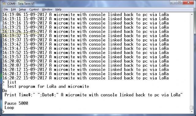

Any way this is a start:
I am not sure that editing a program at this data rate will be successful but I will have a play with different settings to see if I can get a more usable system.

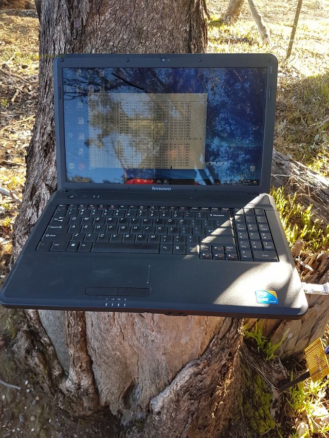

  Quote   I'll be interested to hear back from you as to what range you actually get from them while I wait for my ones to arrive.
Grogs, I did a very scientific range test. With the units set at 10dB power and the transmitting unit on a test bench in the steel clad back shed, I went for a walk to the back gate which is over a hill and about 150 meters from the shed. As the photo shows there were some dropouts but software could distinguish them.
