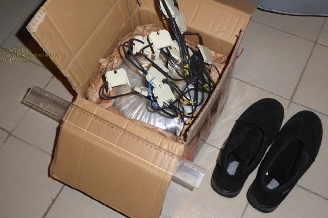

Clockman, I already got my toroid, a year ago, from Germany... It is an heavy 7.5 kW "monster". Only need to unwound all the secondaries and wound new low voltage on ... In the moment just waiting on some components to arrive, to finalize your boards. Will also do some mods on OzCooling pcb. it is voltage dependent...
P.S. SMD fets are still a live, think they will stay there
OffGrid 24/7: 250w black mono solar panels 6.4kWp, 1x Midnite Classic 150, 1x MorningStar MPPT 60, battery bank 840 Ah @ 48v, modified LF-8K inverter, DC/DC, hot water harvesting, etc.

Brac321,
I do like boxes like that.
For the OzInverter with a good general 6kW rating. I find that a silicone iron wound strip core about, 200mm outside diameter, 100mm inner diameter and overall core thickness of 120mm, (2 x 60mm thick cores, stuck together, as it seems that the winding machine most manufactures use is limited to max 60mm).
Weight of the silicone core is a good general measure when selecting other assorted cores or used cores. Weight for the bare core for the 6kW OzInverter should be about 18kg to 22kg.
At 230mm outside diameter, 100mm internal diameter and at 140mm thick the core weighs about 35kg. At that weight a benefit is less copper windings, but one heads into the masochistic area of weight lifting.
And at 35kg core its easy to damage the copper windings as you lift and turn the toroid unless you take special precautions for resting the toroid. I use 5 layers of 1.1mm thick rubber matt.

Just realised I suffer from CRAFT, I went back and checked the number of turns, correct figure is Maximum Flux Density(Bmax): 0.8810 Tesla.
It is close enough to silent with 230V AC connected to the secondary, however, it does buzz working as an inverter.Edited by Madness 2017-09-23
Posted: 11:15am 22 Sep 2017
That is still exceptionally low.
I am in the process of building up a PWM inverter myself at the moment. I don't really need it, but it will be an interesting learning exercise. My battery is nominally 100v consisting of thirty 50Ah Winstons.
Plan to use two completely original Inspire toroids. The Inspire grid tie uses a 200 volt dc bus, but what I plan to do is use two of these toroids just as they are.
Powered off only 100v dc I can only get 115v across each secondary, but with two toroids I can get 230v with both secondary windings in series.
Its a very lazy way to do it, but I just could not be bothered with the whole toroid rewinding drama.
It does have a couple of advantages though. Flux drops from 1.6T to 0.8T because all the voltages are now halved.
No load losses should be very low, and I can mount both toroids flat side by side in my metalwork which reduces the height.
Still working on a very elaborate BMS which is really what this is all about. The PWM inverter is just a minor side project and takes second place to the BMS and battery charger.
