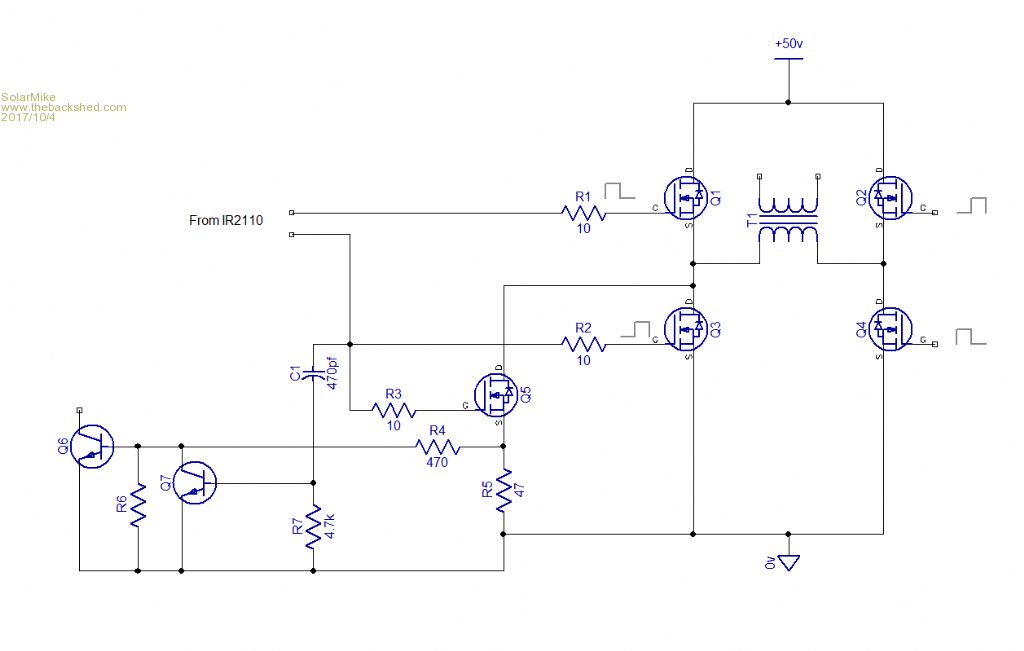

  Clockmanfr said   Until that is, someone designs a OzInverter protection circuit for dodgy HF GTIs. However, reading the last few posts that looks unlikely.
Hmm, I quickly drew this up as a possible solution to monitoring DC current through each 1/2 of an H bridge, by using the internal Mosfets Rds(on) as a current sense. A current mirror arrangement could be deployed on each of the lower H Bridge Mosfets.
Basically Q5 is monitoring the current through Q3, Q2 and expressing that value as a voltage across R5 referenced to 0 volts, this voltage turns on Q6 during overload on any half cycle, Q7, C1, R7 act as a blanking section that prevents erronious readings in the initial switch on event.
I found a circuit similar to this on the web a few years ago, but I havent tested it in this application.
Mike

Posted: 07:13am 04 Oct 2017
Effective inverter short circuit protection should (?) protect the inverter.
But it would take nerves of steel to deliberately dead short the output of a running inverter to test it.
A Hall sensor could be placed between the electrolytic and the bridge to measure dc fault current. Although it is usually an inconvenient place physically, unless its a single large electrolytic with screw terminals.
A more practical solution would be to place a Hall sensor in series with the choke.
Even easier still would be a current transformer in the transformer primary.
The choke should limit the rate of fault current rise to something that a shutdown circuit can then more easily cope with.
All this assumes that upper and lower mosfets don't cross conduct. If they do, its all over in an instant regardless of anything else.

Posted: 03:20pm 04 Oct 2017
Mike,
That is similar to what I did way back for traction motor control. It was very effective... may investigate it further. It used to save using shunts to measure the current, and was virtually instant.
I used to use the comparators output ( thats how I synced it too) to throttle back the controller, but in this case that would simply lower the AC output, and OFF would be better than low.... hmmm....
Always something else to play with.

Joined: 26/07/2007
Posts: 1686
Posted: 01:18am 05 Oct 2017
Ideas anyone?
To do the current sense of the fets, we will have to sample both the low side fets, ie one with the 50hz carrier, and one with the 20khz spwm.
I am thinking this may best be done with a lm339 with 2 op amps per leg. One to do the sync, and one to do the comparison of each leg. ( use all four)
By their nature the rds on measurement is going to change effective resistance by about 30% over the max temp range. This will be mostly relevant to the spwm, as it's switching losses are higher, so will display differently.
The 339 response time is in the 2us range, so I am thinking this may be doable, and perhaps drive a 4069 hex inverter to drive various shut down parameters... eg the 8010 current sense, and the 2110 shut down and panic led perhaps....
These can be latched with high speed diodes, so that off is off forever, or maybe just drive the present current shut down as well.... we cannot have jitter with the torroid lurking about the place.... off must be off and then a soft start from a reset only.
Propagation of the 4069 is in the <200ns range.
Does this sound like a catchall worthy of me trying it out?.. or am I going about this all wrong. I think the comparator is fast enough, and the hex inverter gives me lots of avenues to process the results. I think the time base will catch things in less than 10% of the max pulse width... but is that enough to aim for.
..........oztules

Posted: 11:43am 05 Oct 2017
Great idea and worthy of experiment, possibly a more modern faster comparator with push pull outputs like TLV3202 (50 ns) would work here, couple that with a precision voltage ref chip and something like an RS Latch or similar for lockout until manual reset. 4069 hex inverters would be fine.
There will have to be some adjustment (multi-turn Pot)to allow for the expected increase in RDS(on) with temperature and various numbers of parallel mosfets employed.
When the mosfets first start to turn on and in their linear region, the over current sensing will have to be turned off to prevent false shut downs.
Mike
