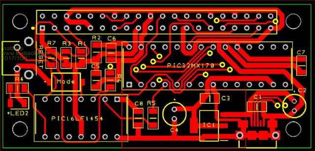

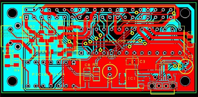

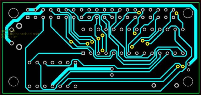

Posts: 11954
Posted: 07:56am 01 Oct 2017
  Quote  especially if Peter could move the micro USB power connector!
Copper pour removed for clarity

Posted: 03:18pm 02 Oct 2017
Again onto the topic of USB micro/mini.
I did not intend to start a discussion on the merits of each connector.
I just wanted to reinforce that a PCB mount connector is more robust than a connector using the top copper layer as the only retention of the connector.
Check out the RASPI - the micro usb has 4 through hole pins.
In terms of the heavy hand and rough usage - is it better to foresee problems and stop these before the event?
The reliability of all the micro usb connectors is due to the fact that they use PCB pins.
We learnt the hard way - all the original UP 3d printers had a surface mount mini usb and the failure rate was high. All the new machines have large USB connectors.
Lets use history as a guide for better systems.
Tony Pugatschew
Posts: 11954
Posted: 09:21pm 02 Oct 2017
  Quote  Check out the RASPI - the micro usb has 4 through hole pins
The Raspberry Pi connector is part number 690-005-298-486 which doesn't seem to be available through normal channels. If you can suggest an alternative I'm happy to look at it but I can't find anything with through hole lugs other than connectors that fit into a cut out in the PCB.
My technique of putting a plate through hole under the pads makes a big difference and I've never had a connector problem despite some pretty rough handling

Posts: 11954
Posted: 01:55am 03 Oct 2017
I've put holes to suit this part. The problem with the aliexpress parts is no drawings so you have to buy and measure them before laying out the board.
Unfortunately Designspark doesn't support slotted holes in any useful way. I think it is time to get some PCBs made
Edited by matherp 2017-10-04
