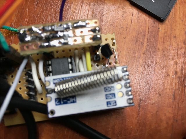

The things that are holding me up from a breadboard test bed are:
- a through hole equivalent of Captain Boing's BS250 (as he foresaw - not easy to find)
- through hole equivalents of Grogster's SMD FMMT493 and DMP2305 (I was thinking I could solder wire legs onto them - I have my wonderful microscope . . .?)
Cheers, Andrew

If you are looking for through-hole versions, I would simply go for a BC548 or perhaps a BC337 etc for the NPN transistor, and any suitable P-MOSFET in TO-92 or TO-220.
With the MOSFET, the only things you need to be careful of is the Vgs(max volts between gate and source) and Vsd(max volts between source and drain)
The Vgs needs to be at least a few volts above the maximum you plan to power the switched device from. In the case of an HC12, you only need a MOSFET that is happy with a 5v Vgs or so, and many MOSFET's support that.

I use upside veroboard to mount these small SMDs so I can add them to prototypes. Below is that NPN + FET circuit plus a voltage reference. Just cut one track and the three legs mount easily straddling the two adjacent tracks and the cut. Just solder some header pins flush where you want to connect to host board.
Gerry

Disco - perfect, thanks. Andrew

Yes, that is very crafty Disco.
