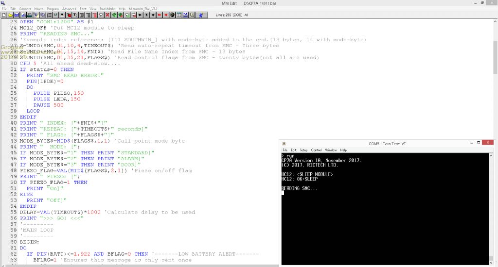

Posted: 12:52pm 05 Nov 2017
OK, I re-flashed the 170 chip to be sure, and changed the code and got ONE successful read.
Thinking I was on a winner, I then changed 'status' to 'S' and added 'S' to the the list of declared integers, and re-ran the code - it crashed when it ran into the very first UNIO access request:
At this point, you NEVER get the console back - I waited about 10 minutes to be sure this time. You HAVE to cycle power to get the console back.
OK, that done and console back, re-run the exact same code, and you get the expected result. Run the code a 2nd time, and the MM2 crashes - you have to cycle power.
So, the first read is OK, but the 2nd one causes a crash. I can repeat this exactly every time. Any idea why that should be?
EDIT: I have changed the code so that all it does, is setup the variables etc, read the memory, and STOP. Still crashes at the same point on the 2nd attempt to read.
My current test code:(not including UNIO C-Function, but it is there naturally)
  Quote  Print "CP7A Version 1A, November 2017."
Print "(C) 2017, RICTECH LTD."
Print ""
Option Explicit
Const LEDA=02,LEDK=03,HLP=06,RST=07,PIEZO=10,SMC=14,HC12=15,VT=18,PPD=23,BATT=24
Dim as Integer BFLAG,SMC_FLAG,RST_FLAG,PP_FLAG,DELAY,PIEZO_FLAG,S
Dim as STRING D$,FNI$,TIMEOUT$,FLAGS$ LENGTH 25
Dim as STRING MODE_BYTE$ LENGTH 1
Setpin LEDA,DOUT
Setpin LEDK,DOUT
Setpin HLP,DIN 'Has external pull-up
Setpin RST,DIN 'Has external pull-up
Setpin PIEZO,DOUT
Setpin HC12,DOUT
Setpin VT,DIN '2272 decoder module Valid Transmission line
Setpin PPD,DIN 'Has external pull-up
Setpin BATT,AIN 'Battery voltage input
Open "COM1:1200" as #1
HC12_OFF
'Put HC12 module to sleep
Print "READING SMC..."
'Example index reference: [111 SOUTHWIN_> with mode-byte added to the end.(13 bytes, 14 with mode-byte)
S=UNIO(SMC,01,10,4,TIMEOUT$) 'Read auto-repeat timeout from SMC - Three bytes
S=UNIO(SMC,01,15,14,FNI$) 'Read File Name Index from SMC - 13 bytes
S=UNIO(SMC,01,35,21,FLAGS$) 'Read control flags from SMC - twenty bytes(not all are used)
CPU 5 'All ahead dead-slow....
If status=0 Then
Print "SMC READ ERROR!"
Pin(LEDK)=0
Pulse PIEZO,150
Pulse LEDA,150
Pause 500
Endif
Print " INDEX: ["+FNI$+">"
Print "REPEAT: ["+TIMEOUT$+" seconds>"
Print " FLAGS: ["+FLAGS$+">"
MODE_BYTE$=
MID$(FLAGS$,1,1) 'Call-point mode byte
Print " MODE: [";
If MODE_BYTE$="1" Then Print "STANDARD>"
If MODE_BYTE$="2" Then Print "ALARM>"
If MODE_BYTE$="3" Then Print "DOOR>"
PIEZO_FLAG=
VAL(MID$(FLAGS$,2,1)) 'Piezo on/off flag
Print " PIEZO: [";
If PIEZO_FLAG=1 Then
Print "On>"
Else
Print "Off>"
Endif
DELAY=
VAL(TIMEOUT$)*1000 'Calculate delay to be used
Print ">>> GO! <<<"
END

Posted: 01:45pm 05 Nov 2017
Hi Grogs,
On the second go are you still at CPU 5. I think you need to set it at the start, its defaulted on first run, but will still be CPU 5 on second go.
Gerry

Posted: 02:36pm 05 Nov 2017
You have "If status=0 Then " but are using 'S' so status will ALWAYS equal zero and should throw a wobbly because it isn't declared.
You refer to the HC12_OFF sub but it isn't in the supplied code.

Posted: 05:21pm 05 Nov 2017
@ disco4now - Bloody Hell!!! Well spotted! That was it exactly. My brain is having a hard time with these UNIO things, but I WILL get it right - eventually!
