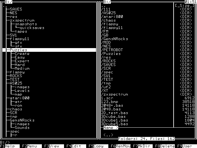

FM v1.75 for PicoMiteVGA/HDMI
+ Adaptive adjustment of list sizes depending on RAM size
+ Directory tree (Alt+F9)
+ HEX Viewer (Alt+F3)
!Need help implementing an HEX Editor similar to the HEX Viewer!

I really like your Dir-Tree. Very good idea and implementation! Congratulations!
I'd like to incorporate it into my FM version – slightly modified. In fact, it's already finished. If you don't object, I'll assume you've approved its publication.

The Dir-Tree is an awesome feature! Thank you!

  twofingers said  I really like your Dir-Tree. Very good idea and implementation! Congratulations!
Hi Michael,
Of course! For our friends from Germany and the whole world, anything!
@twofingers @Amnesie,
Thanks for your feedback!
I tried to implement a very simple algorithm.

In addition to your directory tree, I've implemented an alternative version of the file finder. I tried to solve the problem that a single search can return multiple results. Unfortunately, it's less effective (uses more resources) than your solutuon. It's also not very elegant, but it shows what I mean.
