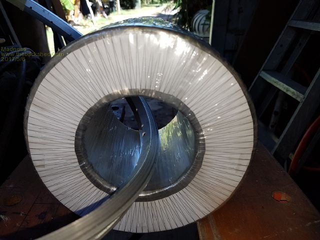

When I made my Toroid I used Rhino CAD (free 30 day trial) to make a paper disc giving me the right position for each turn. I put it under the Mylar before winding the winding the wire so I had the spacing correct.
If you do wind it that way you should wind on a layer of Mylar after you do the first round as you will have half of you AC voltage difference between each inner and outer turn.
Yeh I thought a nice thick layer would be advisable.

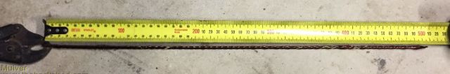

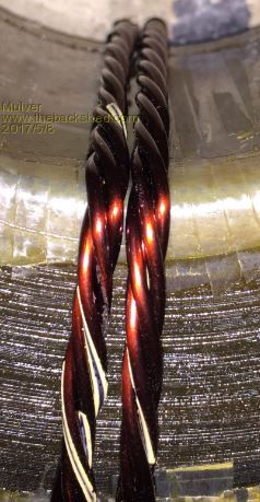

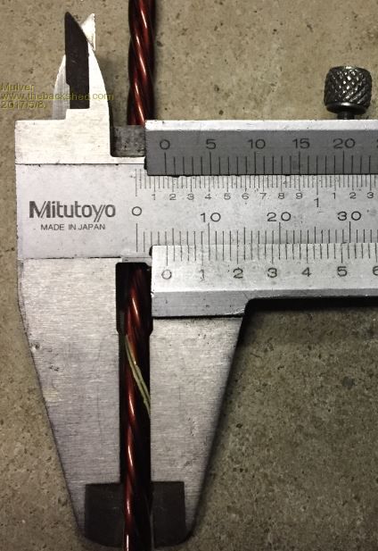

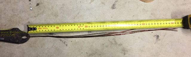

Did some testing on 4 x 500 mm lengths twisted 16 turns it sprung back 1/2 a turn after twisting. lost 10mm in length.

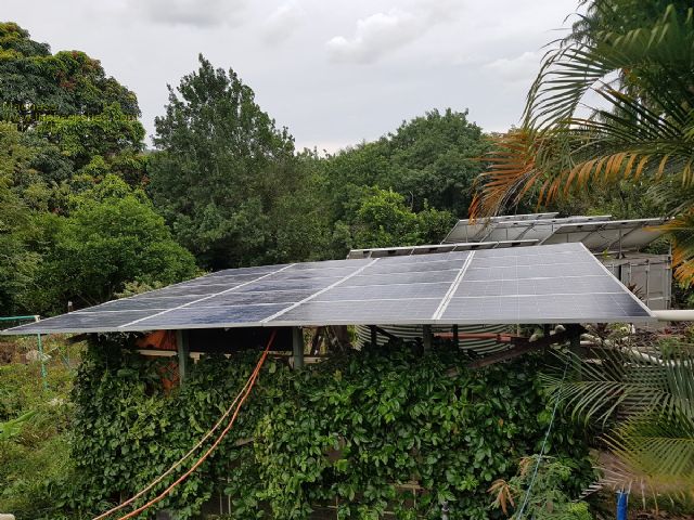

I have now set up the 5KW of panels I recently bought, these have replaced a 2.8KW array that I had in the location.
I have 9.5KW of panels now, as yet I have not had a really sunny day since setting up the new 5KW array, most I have seen is 3.5KW on the GTI connected to the new panels with about 3 KW back feeding through the inverter.
Now I need to work on controlling the excess power I am getting on sunny days. I am very happy with how the inverter is just running without fuss both powering the house and back feeding charge into the batteries from the GTI.Edited by Madness 2017-05-18

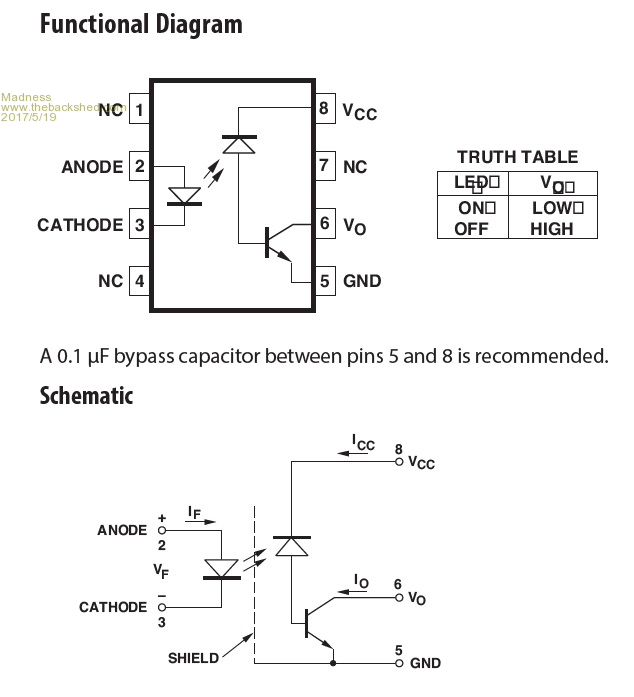

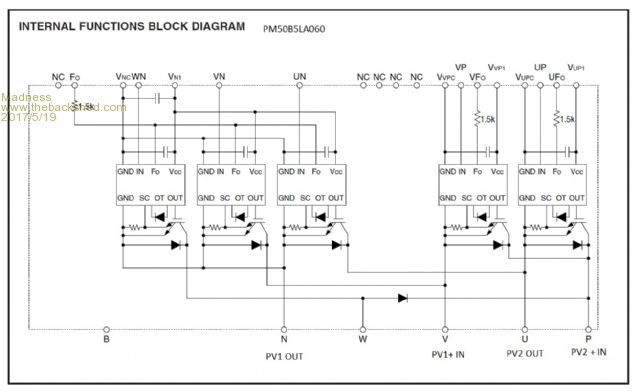

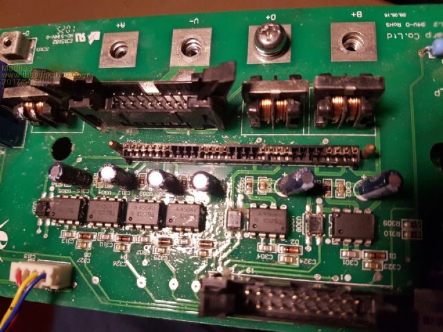

What I am working on is using one or 2 of the IGBT's and the board that attaches to them from the Aero-Sharp Inverters to control the connection from the solar panels to the GTI. By using PWM to control this it could supply the right amount of power required and no more. I would still try to utilise as much power as practical and still divert power to the HWS and AC.
I may be completely wrong here (I am no electronics guru, just feeling my way around in the dark) but if I connect the panels to the IGBT as per this diagram I can control both PV array's to the GTI with a bank of capacitors across each output to smooth out the DC.
This is the opto isolator board that comes with the IGBT
The isolator chips are 2017-05-19_042919_AV02-0867EN_DS_HCPL-4504_2014-01-070.pdf 4504
I think all need to do is supply the correct voltages to the PCB and 5V across pins 2 and 3 to turn it on the IGBT. As yet I have not worked out the supply voltages but I see pin 8 of the isolator require 30V.
The Arduino circuit from the thread mentioned in the previous post could be used to control it and it will be very easy to program charging times and voltages for absorb and float with the Arduino microcontroller.

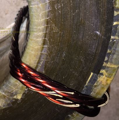

This is a great idea. I'm going to give this a go. How much length did you lose when you twisted the 8m lengths?

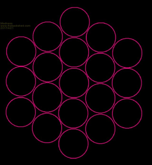

  Madness said   I have just wound a primary on a single core using the wire that was removed, I will get photos later. It saved me close to $100 to buy welding wire and only took an hour to prepare for winding on the core.
What I did is measure out 19 lengths of the 8 metres required (1.1v per turn X 24 turns). I then tied the wires securely to a post got them as straight and parallel as practical. I put a small cable tie every 300 mm to keep them in place and made a clamp out of 2 pieces of pine with a hole drilled in the middle a little smaller than the combined wire diameter and clamped it onto the other end of the wire. Then I just pulled and twisted it until I got a good amount of twist on it. Then I wound it onto the toroid, the wire held together with the twist and was quite easy to bend around the corners. I have tested it and it runs fine, now I need to put some epoxy on it to keep everything stable and the job is done.
24 turns of 1.6 X 19 wires fitted nicely in the space available in the single core, I had to use a tyre lever to push open a gap for the last couple turns. So I now have a 38 square mm primary for next to no cost.
Why did I use 19? Here is why and it ended up 8 mm diameter.
Madness
Joined: 08/10/2011
Posts: 2498
Posted: 11:11am 30 May 2017
When you twist it there is probably less than 300mm but I would allow 500 to be on the safe side.
